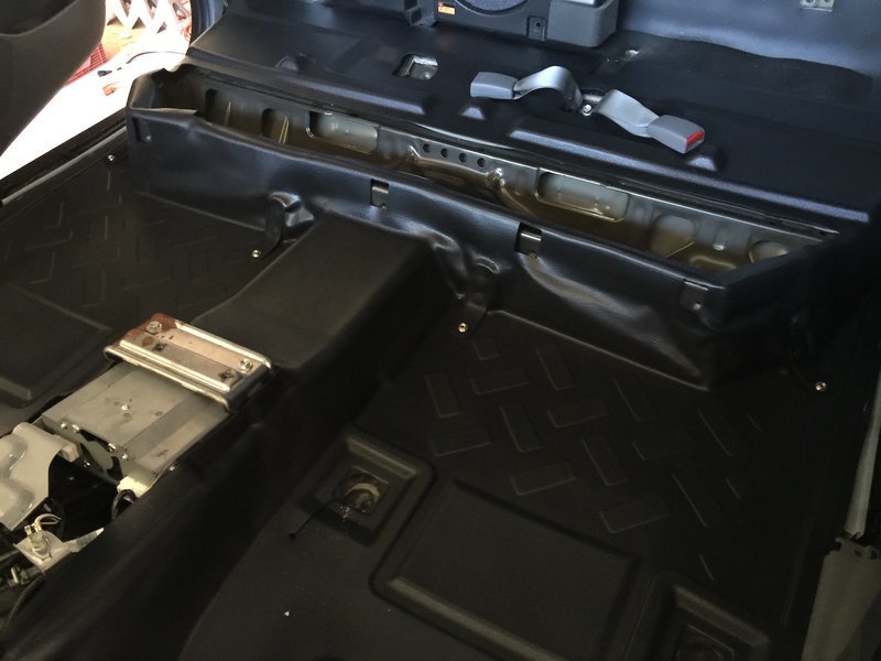

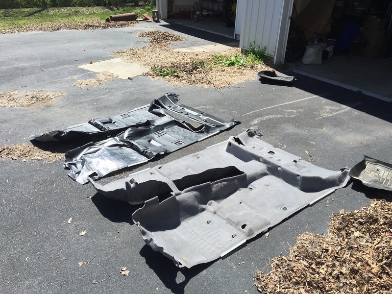

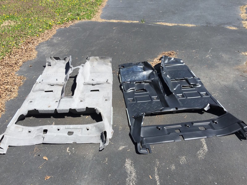

    OEM double cab carpet next to double cab all weather floor
    [​IMG] [​IMG]
    Note: The floor mat hold down grommets and tabs are not installed on the all weather floor. I dropped my old weather tech digital fit mats in on top of it just to help keep things clean-ish in the cab.
    [​IMG] [​IMG]
    My truck already had sound dampening material in it before I added the all weather floor. If you have thought about adding some sound dampening material, this would be the perfect time to at least do the floor since you will have everything out of the way already. It really does make a huge difference in the comfort level inside the cab.
    The part name on the label is "carpet assy, floor" which is confusing when trying to order but it does check out.
    Toyota part # 58510-04870-B2
    Toyota says that it's worth $551.86. This is the best price I could find.
