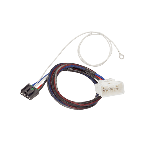

    Do you think splicing into the 3017-p ground wire and attaching directly to the frame where the other ground wires are in the same kick panel would alleviate this problem? I just looked up my Amazon order history and have the P3 with the 3017-P wiring harness. Probably safest to just swap out the harness...
    Edit.... I just found a photo of the 3031-P on Tekonsha's website HERE (Fun Fact: They don't offer the 3017-P for Tacoma anymore. Sorry, but thanks for the heads up OP!). It appears that the extra ground wire is in the same pin (obviously) as the original ground wire. I will be modding my 3017-P harness to match because it'll be quicker/easier than ordering a new 3031-P. I'll let you all know if my truck burns down :bananadead:. Perhaps it would be a good idea to add an in-line fuse too (amperage?)
    Another fun fact....The 3031-P is twice as expensive as the 3017-P on Amazon. Don't be mistaken, I still think $20 insurance is worth not burning down your truck! :rofl:
    New 3031-P connector
