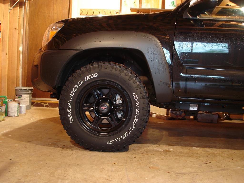

    I run Good Year Duratrac 265/75/16 ,stock suspension. The wheels & tires aren't heavy .Rims weigh 21 lbs & the "C" rated side wall is not heavy at all. My four banger goes as fast as I want it to without any trouble. The truck is very light & my milage is super good with a five speed stick. Heck ,if I want sports car performance, I drive one of my other cars. The Taco is a pissa of a truck .:rolleyes:
    greenpants.....mike[​IMG]
