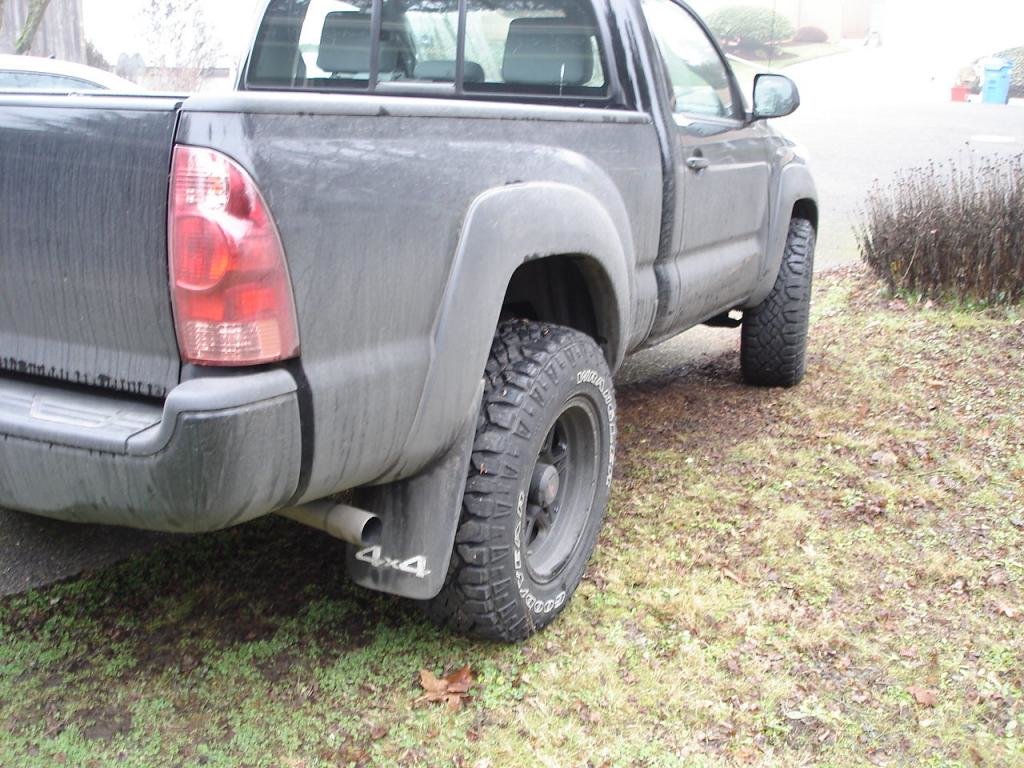

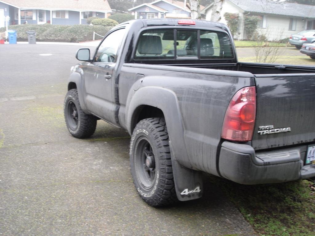

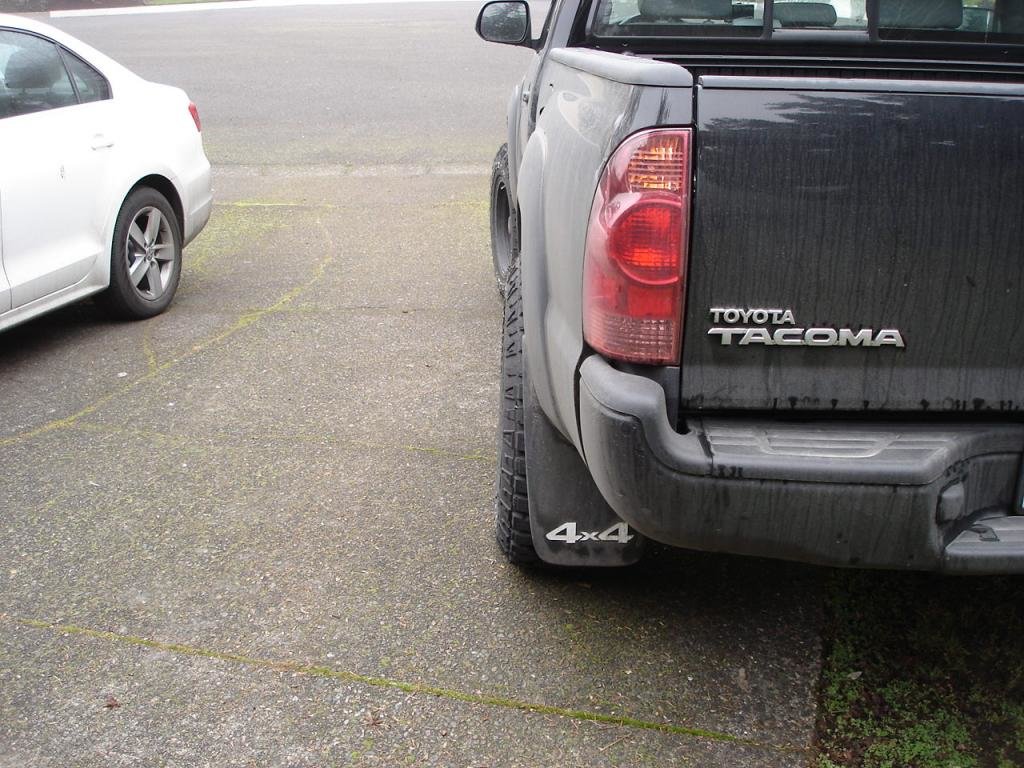

    Here's a couple different angles. Obviously they don't stick WAY out, just about 12 mm, haha.
    For what it's worth, we had snow and ice on the road for a little over a week in mid December (rare for us), happy to report the Goodyear Duratracs (as well as the Tacoma) did awesome on that.

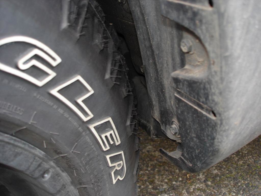

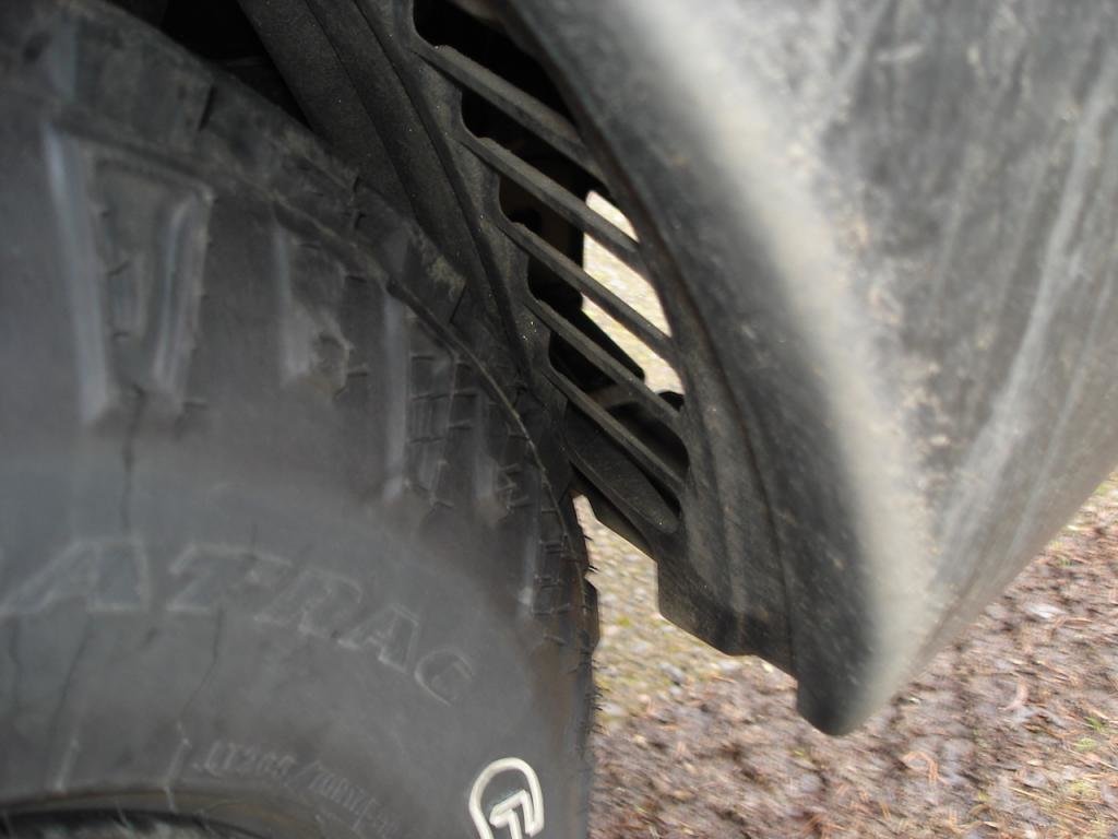

    I get rubbing when backing with anything more than a mild turn. I also get rubbing when going forward, turned tight, while braking. As long as I'm accelerating it's fine.
    I"ve got 9" wheels with -12 offset. I think being "pushed out" is the problem. If the wheels had about 1 inch less front space they wouldn't rub at all on the front plastic. Eventually I'll get around to taking a heat gun to the inner plastic fenders. I imagine any kind of off roading would also have the back of the tires hitting the cab mounts. So I'll have to address that as well. I'll take some pictures of what I'm talking about later today, if I can remember it.

    Here's a couple pictures. Not really sure if it's clear how close the tires are to the inner fenders or cab mount in these, but sitting fairly level the tires are about 3/8 of an inch away from these respective parts.

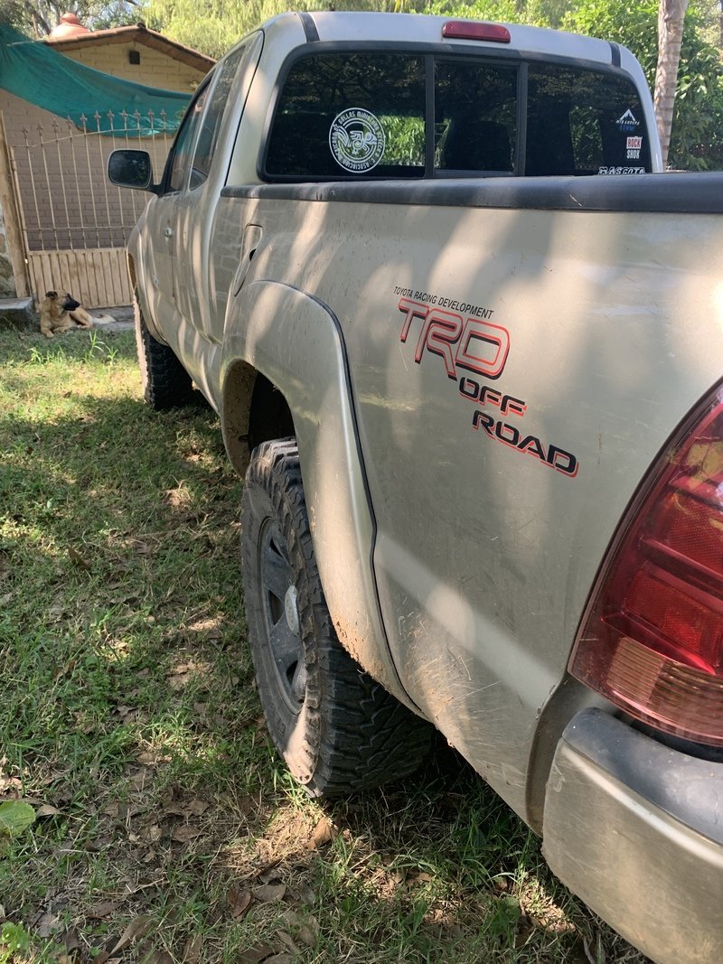

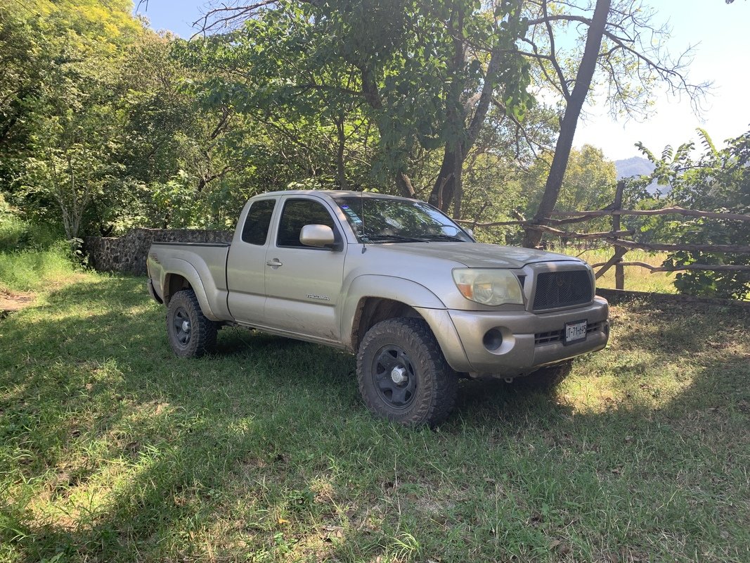

    05 AC 4x4 2.7 5spd
    OME 883/Nitros

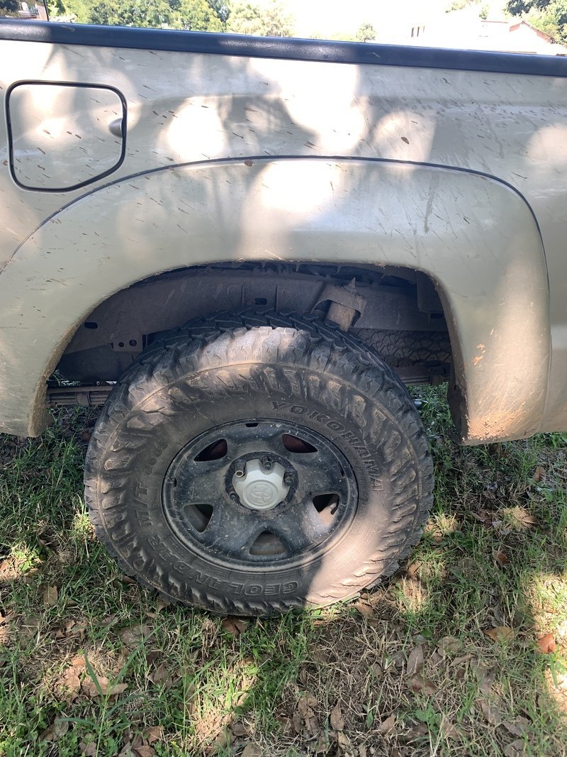

    The 265s definitely roll better then the previous 255/85s
    Yes I know, need to give her a bath.
    The Yokohama Geolandar MTs seem tobe lasting longer then the BFG MTs
