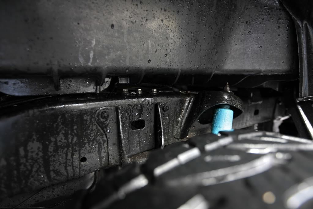

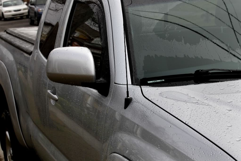

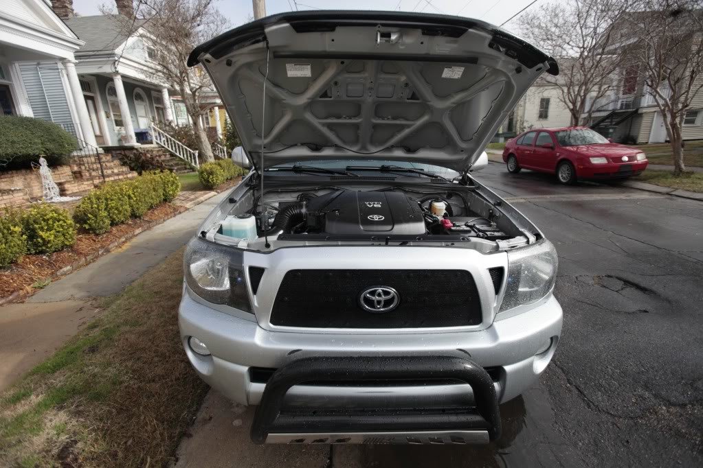

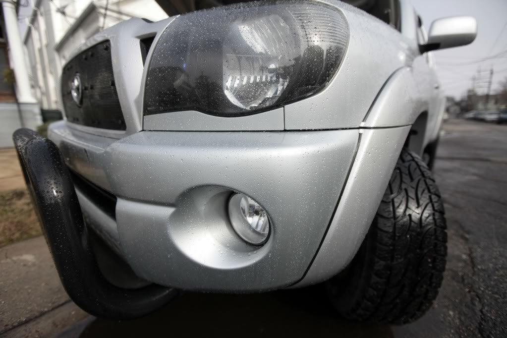

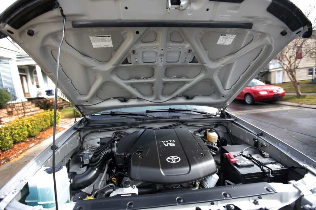

    Process:
    -Power washed undercarriage and engine bay at a self serve car wash bay
    -bought a creeper and got under the truck and scrubbed coils, shocks, frame, etc. (I lived in the Northeast until this year and I wanted to inspect for rust and eliminate any possible residual road salt, as well as restore it to its best condition possible)
    -cleaned the engine bay, undercarriage, and wheels with Simple green and the ferret brush (more about that in a minute), then sprayed the undercarriage and engine bay with Bare Bones.
    -washed the exterior with Mother's California Gold (two-bucket system and a microfiber mitt)
    -full clay bar treatment
    -polished any scuffs with my Porter Cable random orbit polisher and Sonus SFX-1 cutting polish
    -full polishing with the PC and Sonux SFX-2, then another full polishing with SFX-3 fine polish.
    -full acrylic sealant treatment with Klasse SG
    -one coat of P21S Carnuba wax.
    I must say the most awesome tool I have now for the undercarriage, wheels and engine bay is the ferret. Women have the rabbit: we have the ferret. It is absolutely indispensable. Just bend a curve in it and you can clean coils, hoses, inside the rims, etc. It has changed my life.
    http://www.chemicalguys.com/THE_AMAZING_FERRET_WHEEL_RIM_ENGINE_BRUSH_BI_p/acc_s31.htm
    Unfortunately, it rained all day on day two, so I worked under a carport, but by the time I was finished it was dark and raining, so I couldn't even crack one open and sit back and admire it....I just drove of into the rain and got it dirty again.
    I did a quick hose down this morning before I left for work and shot these pics. There's a few drops of water on the engine cover but I didn't have time to clean it up. The water actually helps show off the pristine condition of the paint. In the close up of the water drops, that is a refection of the power lines, not scratches. My '06 has 62,000 miles on it but I must say it looks brand new...

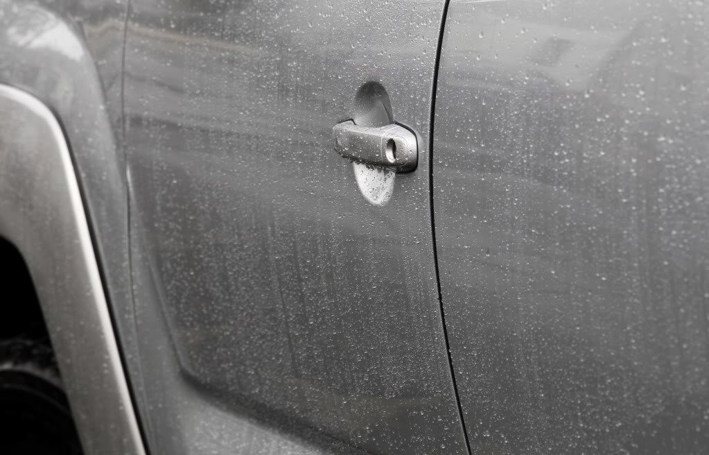

    this that scratch i see :eek::eek::eek::eek::D:p

    power line reflections.;) I thought it was a scratch at first when I looked closely at the photo..
