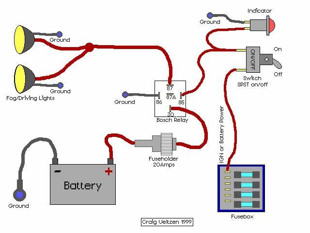

    This picture pretty much explains it all extremely easy. Except each fog doesn't have a ground like in the picture. Literally the most confusing part for me was what to do with the wire going to IGN power. Its pretty much an empty spot in your fuse box that comes on with your ignition. (if i remember right it was top row 4 from the left. not sure though) and i did it the easy/fast way. I just put the wire under a 10watt fuse and shoved it in the hole. you can buy an "add a fuse" though which works better.

    If you have the plugs behind the bumper, your truck is pre-wired.
    You just need an OEM switch (about $45), relay, fuse, and the housings.
    The eBay kit is nice, but the electrical sucks and the switch does not properly fit the dash (it does fit the '12 under the radio).
    The only problem is the housings are known to leak. I've got condensation in mine and it has corroded the reflector.
