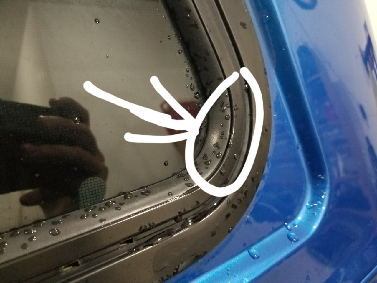

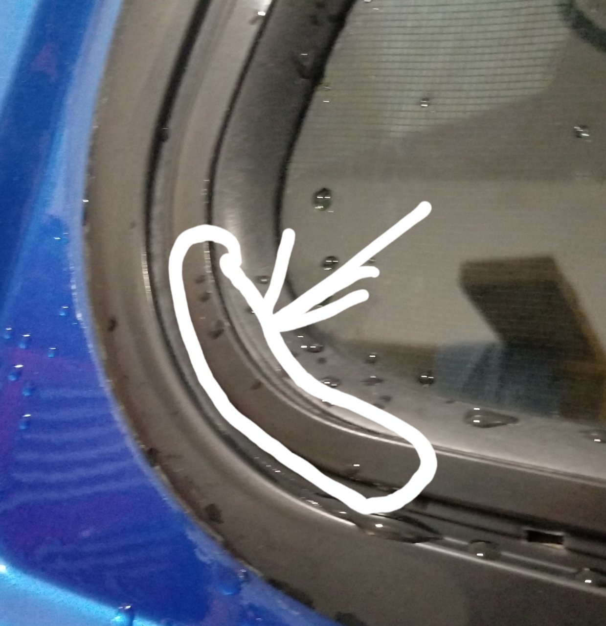

    My cap leaks from the front bed pocket area. I had a window leak a while back. I moved it around to see if it wasn't shut right. That didnt totally work but helped.
    Next I looked at the gasket/seal around the window. I just ran and got a pic but what helped reduce the leak was pushing the seal on the outside back where it's supposed to be. I need to do it again but my seal would come off and not seal properly.
    GOOD
    BAD
    Might not work for you but that's what worked for me. Also to simulate rain spray where it leaks with a garden hose that way you can test stuff that you've done without waiting for rain or snow.

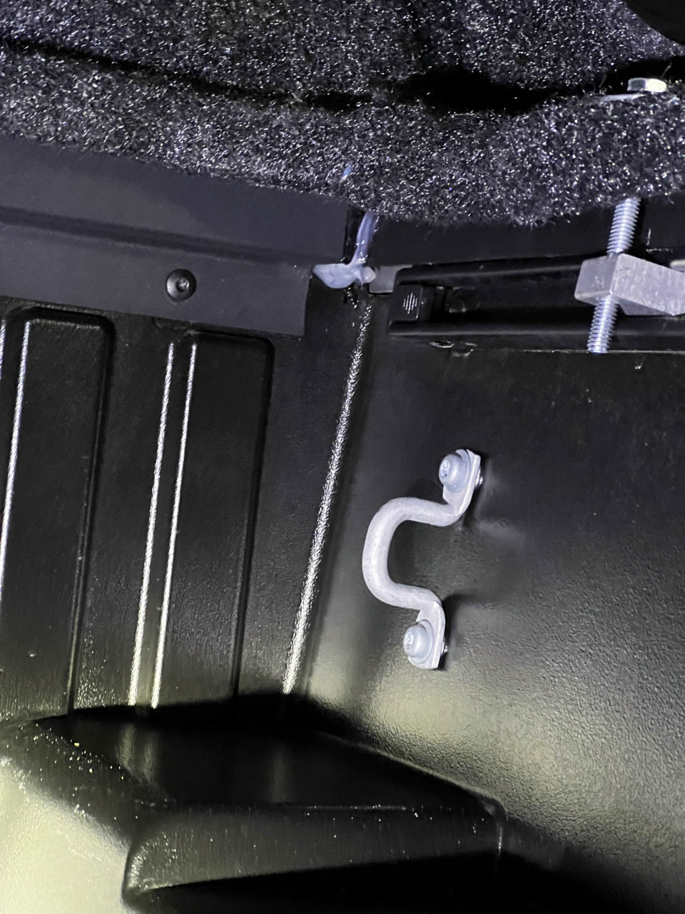

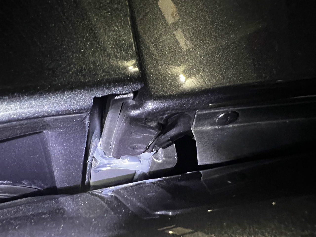

    First pic is sideways (damn iPhone) but its behind the cab, front of the bed. Second pic is inside the bed upper front corner. Both front corners are caulked that way CAC7AA05-AFCF-401E-A383-7A5DED1CCCD6.jpg 119BC304-F2BF-4704-A52B-6410C9074DA4.jpg

    That's awesome. That's how they siliconed mine. It'll look even better after 6 years outside and it starts to yellow.
    That's a HUGE gap you have on the outside front corner. That doesn't look right.
