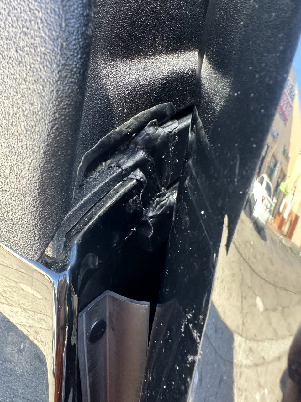

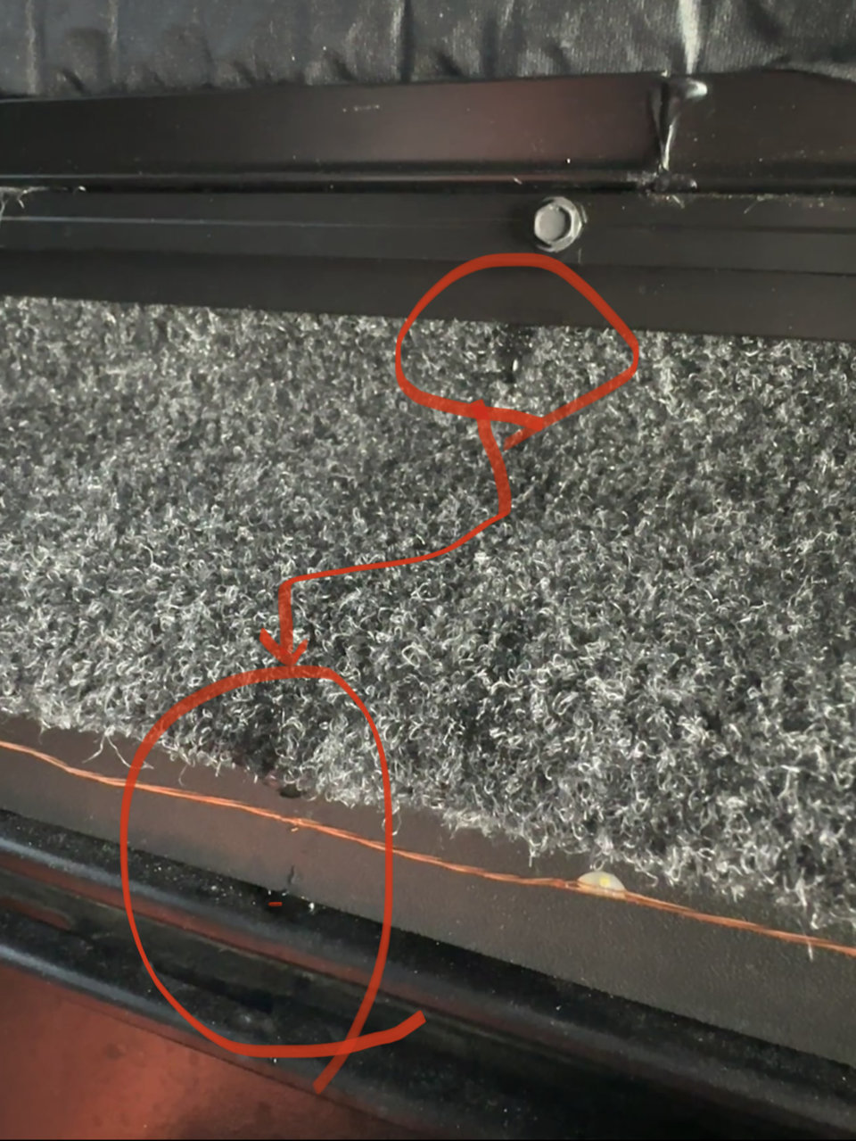

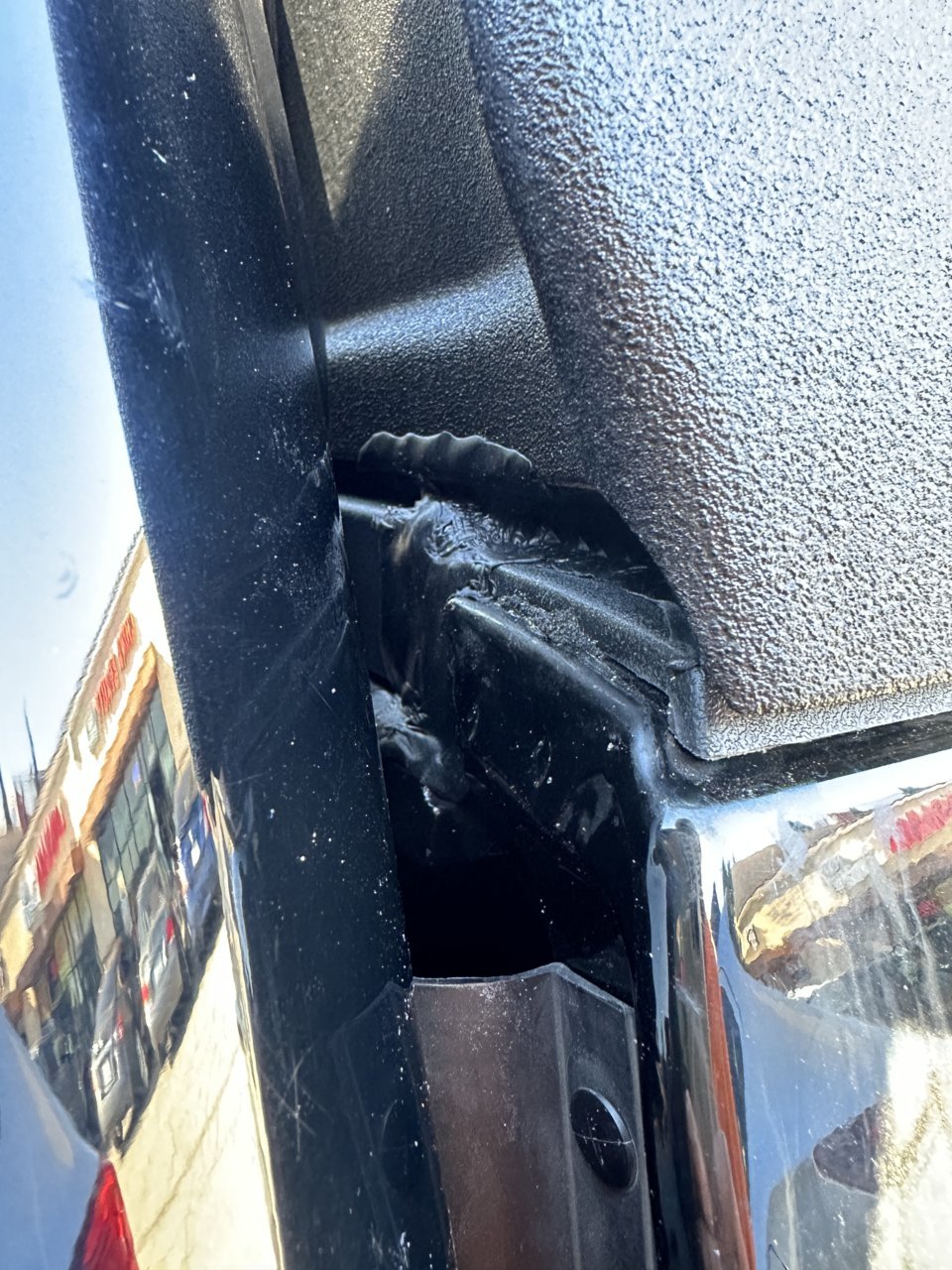

    I have ARE CX Classic for about 3-4 months and have had bad leaks almost everywhere.
    Shell itself might be leaking by windows since there are few spots right underneath my side windoor where the carpet liner gets soaked, not damp, completely soaked.
    Leaks from the two front corner gaps like everybody else. I’ve switched my foam seal to previous mentioned ESI Super Cap Seal on all 3 sides of the shell. Also added more silicon, RTV and then added Butyl Tape on the outside.
    I’m new to all this, so my knowledge level is not that deep. I hope the outside seal helps. I forgot to clean with alcohol wipe before putting the tape on, so I’m just crossing my fingers it will hold up. But then again, it is an easy job to put that on.

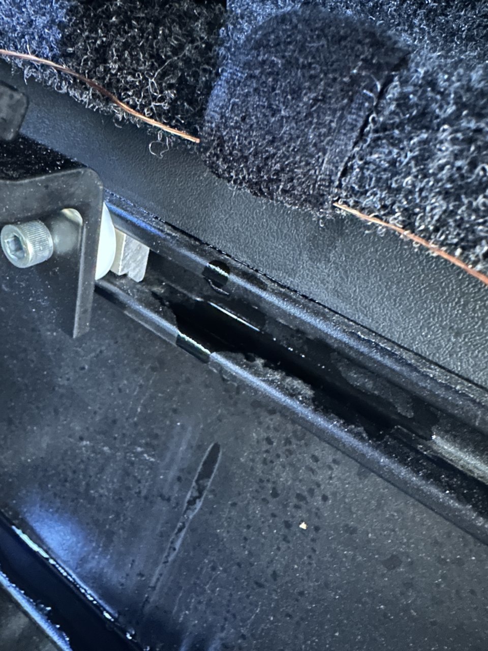

    Aside from the shell, the bed issue:
    I get leaks from metal side rail and water pools up on the track rail and drips down… I’ve added added some stuff to seal the bolt threads hoping that helps. I can’t tell if the side caps are the cause or the metal rail itself. I’ve added more seal under the side cap for now.7CEF9EB6-F424-4F96-BE38-9E9B768D1619.jpg

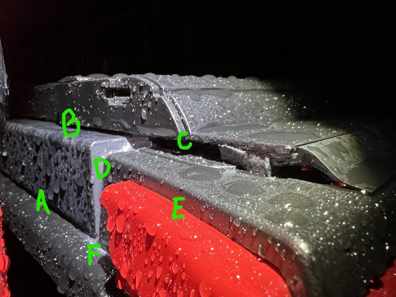

    Thought I would add to this since I cannot for the life of me get my Pace Edwards Ultragroove Tonneau Cover to stop leaking at the front of the bed, it is leaking and pooling on top of the fender wells (right in the inserts for 2x4s). Below I have attached a terrible photo with letter explaining what I have tried and so far to no avail...
    A) The header rail leaks underneath - Since this photo I have taken this off the bed and run a line of butyl tape between the bed and header rail, may have helped some.
    B) I currently have a piece of thick weather stripping foam that runs across the top of the bed (I have to be able to remove the tonneau canister cover to clear debris from the drains) but I think I will add butyl tape along with the foam.
    C) I had weather stripping foam applied here as well, since this photo I filled the gap with butyl tape. Not sure if it has helped.
    D) Originally I filled this with outdoor caulk, this did not help. Ended up constantly cleaning water stains from the caulk that never set (was applied a month ago). Removed the caulk completely and replaced with butyl tape folded over and crammed into the crack. I will need to add more butyl tape or resort to the use of black spray foam.
    E) Stock bed rail, nothing originally - Since this photo I have also sealed this portion of the bed rail caps with butyl tape.
    F) The caulk (pictured) did not work. - I ran the butyl tape I applied at location A (after removing the caulk) all the way across the bed under the header rail and crammed it into the gap F.
    I am running out of patience and I want this thing to seal better than it has. I don't know if this bed design by Toyota is to blame or the cover, either way it is super frustrating...
    Any input would very thankful and I hope you all find the source and solutions to your leaks!
