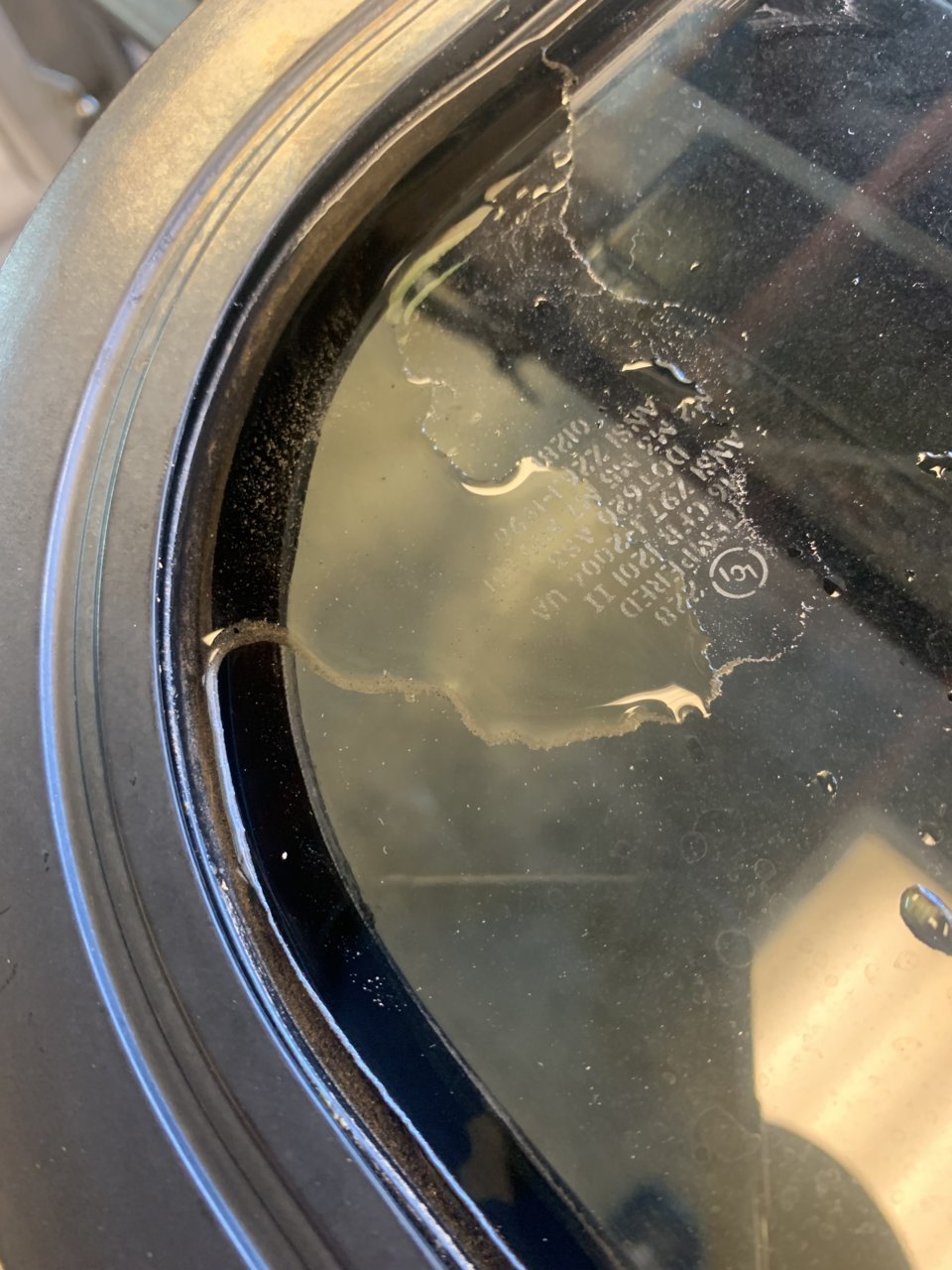

    I had leaky windows on a 3 year old ARE DCU and I discovered that they glass wasn’t glued very well to the frame. I discovered this by pulling the window out, laying it flat and pouring some water on it upload_2023-2-11_19-17-45.jpg
    I then removed the rubber strip and saw the water getting through between glass and frame, it wasn’t glued well at the factory. The rubber strip that pushes in and surround the glass isn’t designed to keep water 100% out

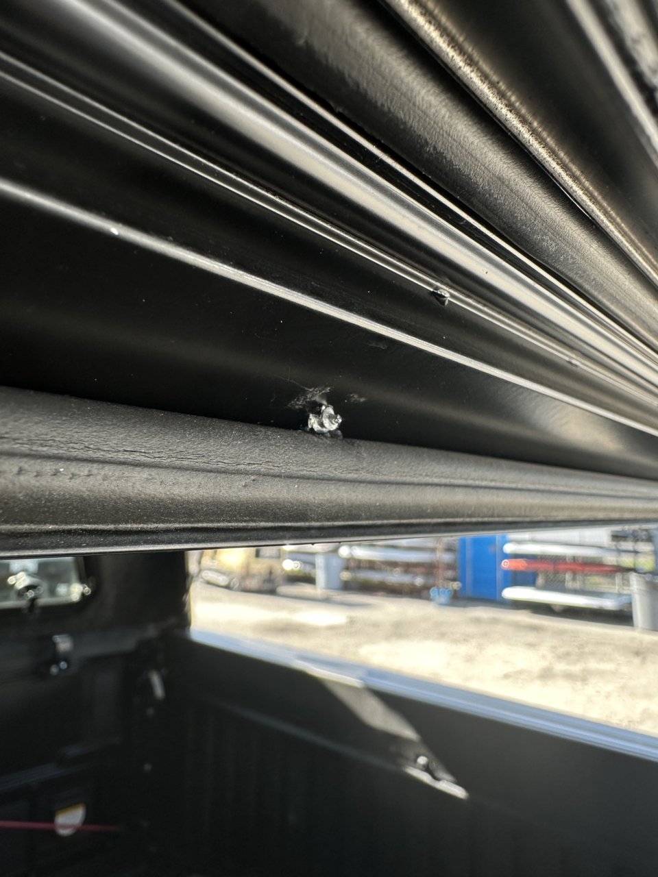

    Hey y’all,
    I just picked up my shell from the warranty repair for leakage. (ARE CX Classic with OTR finish)
    I was told ARE recently had switched to new sealing, but they did not account to test on OTR to see if the new sealing works good.
    I don’t know how a company this big would make such a move on their production and not even perform a proto-review…
    Anyhow… they switched to the original sealing that works with OTR now.
    BUT, when I went to pick it up… it came back with a “new” damage…
    Whoever worked on my shell at factory drilled the screw through when mounting the window frame…
    So now, I gotta wait another 3 weeks for a new windoor to get here…
