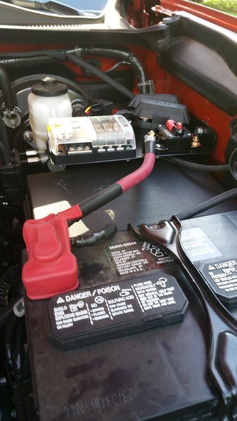

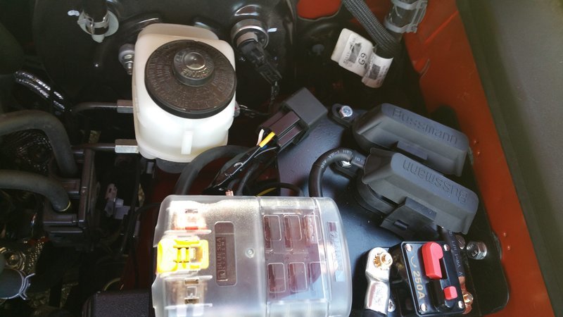

    Wasnt paying attention lol. Yeah this is what I'm looking for. For you guys who know more about electrical than I do and are good with numbers: Ran a 4 ga line to my own wiring setup. 250amp breaker/kill switch feeds a 100 amp fuse for a blue sea box and a (up to) 150 amp fuse for the inverter. Inverter will mostly be used for kids electronics on road trips, but also the odd power tool. I want it to be able to run my back up pump for the sump on my house during a power outage. That would be the biggest draw. Runs at 3amp 120v (30 amp on 12v) and surges at 9amp to start (90amp on 12v). To start the pump I need roughly 1080 watts. Even with the biggest draw on it it will only consistently draw 360 watts. Won't be huge drain on the battery, especially with the upgraded alternator from the tow package and a relay to make sure the inverter only runs when the truck does. I'm satisfied with all the head scratching for now, just need to find the parts I want for a clean install. Like I said earlier I want it to look good. I really like the idea of having just outlets wired to the inverter rather than trying to find somewhere to mount the inverter that looks good. They can be big and ugly. Thanks for the help guys. I'll check out that thread on console removal, but if I remember right I watched it already, and I'll be back with more questions. Thanks again!

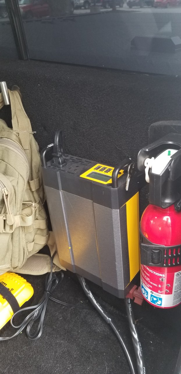

    I know this amperage is wayyyy below what you're trying to do, BUT, the mounting location is great for folks who might not need much more than basic. It'll fit right on the wall of your center console with some Velcro and plug into the secondary cig outlet there. Also...it's cheap :D
    FOVAL 150W Car Power Inverter DC 12V to 110V AC Converter with 3.1A Dual USB Car Charger https://www.amazon.com/dp/B01H2XD2DY/ref=cm_sw_r_cp_apa_i_JvqZCbA62JBGR
