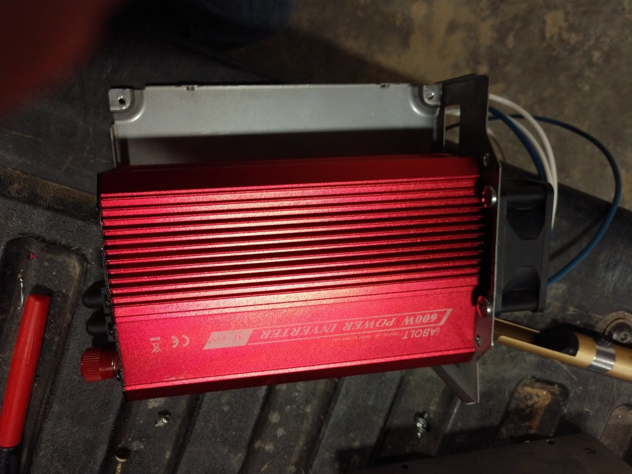

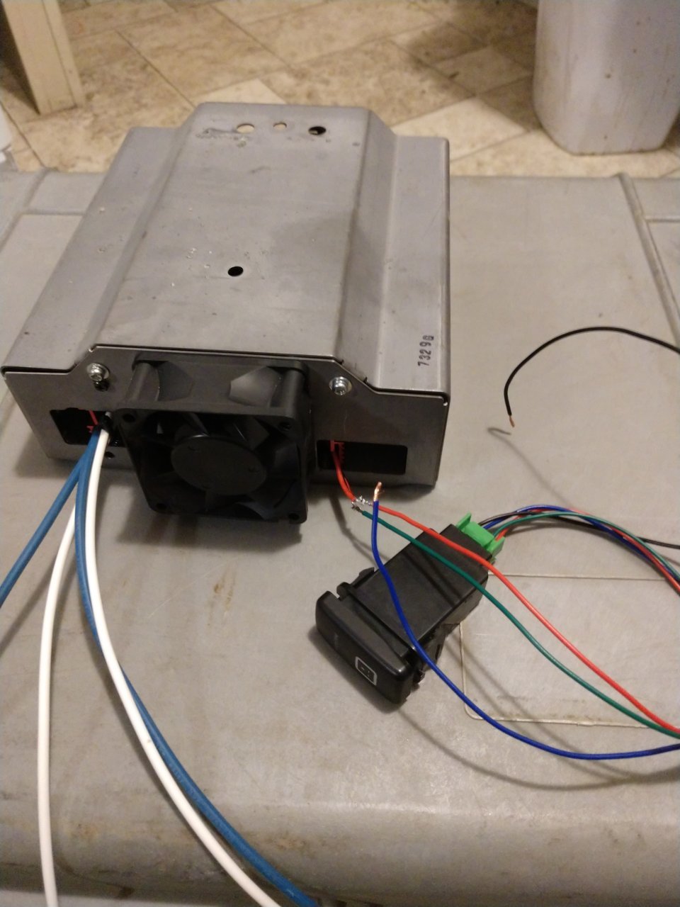

    Yes.
    Toasted something major that makes using the factory inverter not a possibility. Sooo.
    Found a 600w that fits in the housing of the original inverter. Bought a separate on/off switch, used the original wiring to tie it all together. And just bridged the 100amp relay under the hood by wrapping a good amount of wire around the main power poles, so it's always on now. (I also use that power supply for my ham radio).
    Also wired in two outlets in the cab of the pickup.
    Just finishing everything up now...
