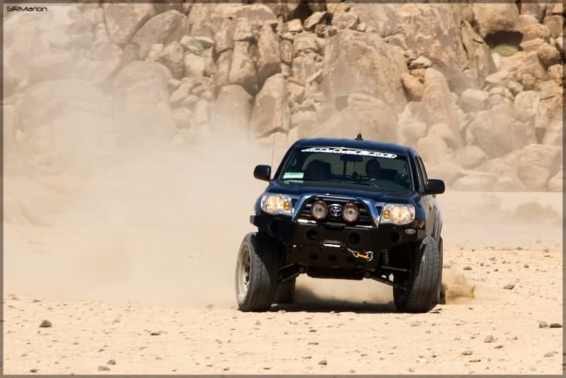

    no swaybar here, but my setup is just a lil different from most :D...
    LT Taco lean anyone!?
