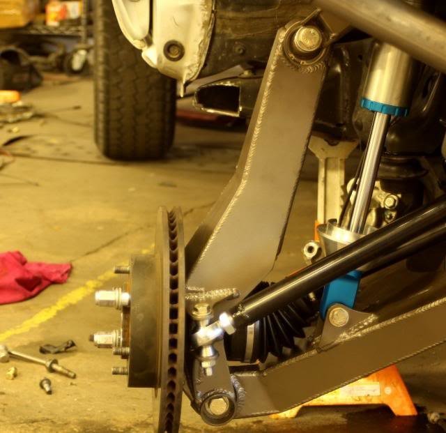

    What all does your patent cover on your suspension and/or steering if you dont mind me asking? Only reason is your upright is almost an exact copy of mine.
    https://www.tacomaworld.com/threads/dirt-designs-05-taco-4wd-race-kit.284268/
