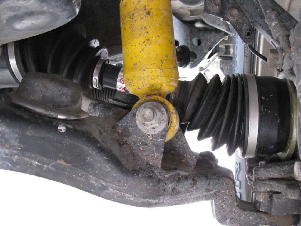

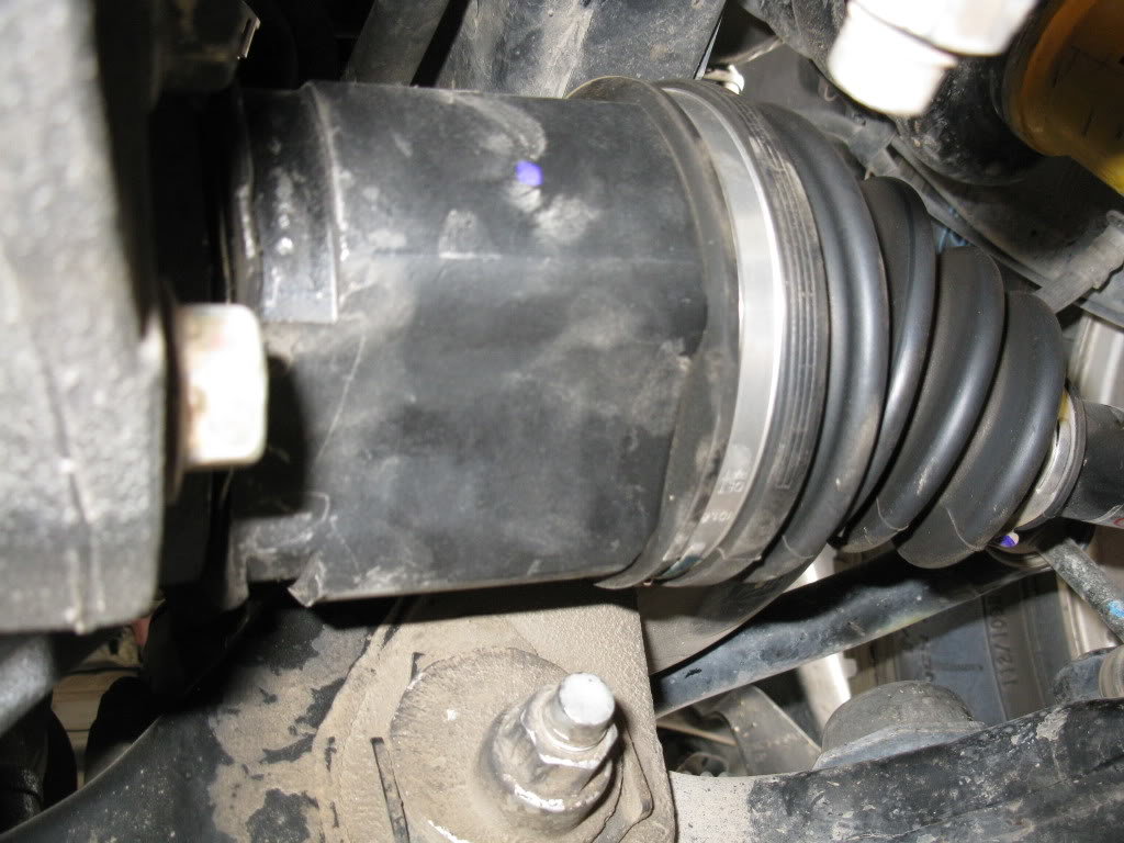

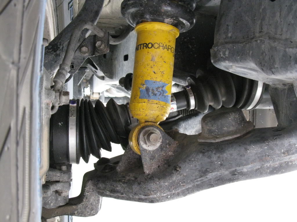

    I'm going nuts. Can anyone tell me what they think my problem is? Why would my axles look the way they do. Are they installed wrong or something?
    For the past few months, I had this wooping feeling like a flat tire and a shaking or loose feeling in the in the floor and gas pedal. I took the truck in to the dealer we discovered my axles had a really bad wobble to them which I had replaced. At the same time I had an alignment done as well.
    I figured this would solve my problem but I was wrong as I still had this strange feeling in the floor and gas pedal. I ended up taking the truck to a differential shop where they told me my front diff was bad and my carrier bearing shot. They fixed the diff and replaced the carrier bearing which got rid of the wooping feeling but I still have this strange feeling in the floor.
    Well it's about two weeks later and I think this feeling is geting worse. I get under the truck tonight and started looking around. I noticed my cv axles looked messed up. The fins on the boots are touching now and the axles look weird. It looked fine after the axles were replaced. I also notice that there is some play when I try to rotate the part of the axle that goes into the diff. I don't know if a little is normal or not but there's no play when I move it up and down and side to side.
    I don't know what wrong. I'm sick of throwing money away. Could part of my problem be from a bad alignment, axles axles being installed wrong or from the diff drop? My tires seem to be rubbing a little on the upper control arms. I need to get new ones to correct my angles since my ball joints look horrible and one has a small tear in it now.
    I have a carrier bearing drop, 881 springs, darkars in the rear, and a diff drop.

    With 881's, you're getting more of a lift than a 1" drop is compensating for. Try a 2 inch drop or a poor man's spacer drop on top of your 1". It flatten out that cv angle quite a bit.

    More of a drop? How much is too much? It was fine for the first 5 months or so and then everything started to happen including the head gasket. The fins on the previous axles weren't even this close. I don't even think they were that close after the got the truck back from the diff shop.
    I don't think I've read about anyone with more then a 1" drop? If I drop it any more, I don't think I'm going to be able to put my skid plate back on which I haven't modified yet for the 1" drop.

    Those do look steep. I have the same set-up in the front of my truck w/out a diff drop and my fins do not touch.

    the axles dont look funny to me... a little steep but not bad
    have you tried jacking it up and looking for slop on the wheels. wheel bearing, balljoints would have been my first step. CV axles dont usually cause to many issues. you can hear them long before feeling them...
