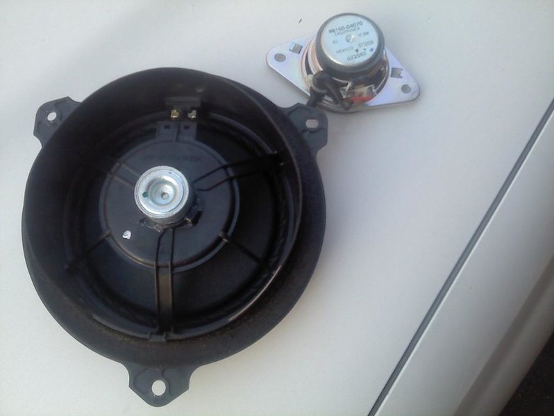

    Sure about 6x9 on the RC?
    I was concerned about the ********* adapters being for "round" speakers, but lo and behold, these are my stock speakers:

    I'm a DC and they appear to be 6x9. But they look the same, that shit is nice they put in from the factory ain't it? Can't believe they sound as well as they do.

    Indeed.
    I upgraded because mine were muddy as hell. FM music was worthless and not worth listening to, they were okay on newsradio.
    I thought it was because the tweeters were either not included in the RC Base, or they were complete shit.
    But those primary speakers?
    Yes, I can stick a tweeter to one and lift it by the tweeter.
    I can BARELY lift the tweeter by the speaker.
    Speaker to speaker? Zero mutual attraction/repulsion.

    The door openings are certainly more than adequate for the 6.5 and maybe even larger, but I don't think a 9" would fit.
    Here's the ********* adapter... For the Polk DB6501 midrange I ended up drilling right about the middle of the "n" on the "*********" engraving.
    http://shop.*********.com/images/11560127201671373845789.jpg
    I guess I could run out to the garage tomorrow and measure the lip on the original speaker... that is the size of the door opening.

    The flange is just a smidge under 6", so I'd say that the opening in the door is either right on 6" or just a hair over.
    The problem with aftermarket speaker measurements is that the "6" is a nominal measurement. A 6.5" speaker will generally not require a 6.5" cutout. Because of basket material, there might be a 6" speaker with a cast basket that requires a larger cutout than a different type 6.5" speaker with a stamped basket.
    The biggest issue with the Taco (since virtually any 6.5" speaker will fit) is the magnet depth interfering with the window.
    This is not unique to the Taco... my '03 Tundra had that issue too. The Tundra didn't have the luxury of a large pocket on the door panel, the grille was pretty tight against the speaker.
    The solution was to remove the bolt that secured the bottom of the front window track and reinstall a longer one with a couple of nuts as a spacer.
    You could go to 2 nuts (about 1/2-3/4") before it flexed the glass enough to overload the power window motors.
    The ********* kit will let you run a speaker with a mounting depth about 3/4" deeper than without an adapter.
    Of course, ********* is not the only source for a spacer, but it's a bolt-on ready to roll.
