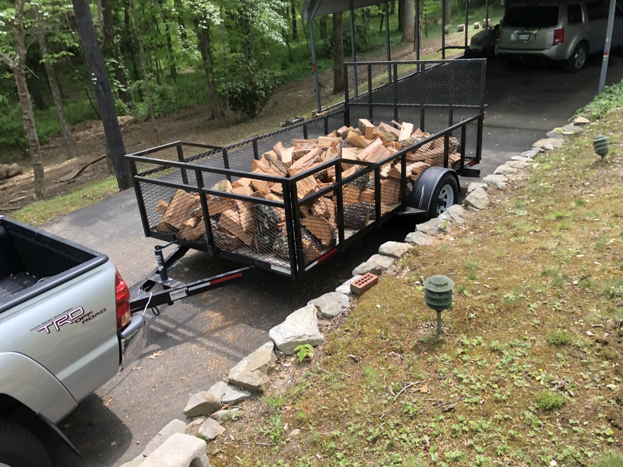

    I would do a drain and fill. But not because of towing.
    Why? Read about it here
    https://www.tacomaworld.com/threads...e-get-it-out-of-your-transmission-now.331521/
    FWIW, I did my first Drain and Fill at 100k. I didn’t know any better, and was told by the dealer I was good until 100k. That was WRONG. (Maybe not “wrong”. But it was not the best advice)
    And also, Yes. I do still have WS fluid in my transmission. (140k now)
    Why did I continue to use WS?
    Because I didn’t feel comfortable doing a flush at 100k. I am choosing to do drain and fills. Doing this only gets maybe 1/3 of the fluid out each time.
    (My trailer alone weighs more than 350 lbs).
