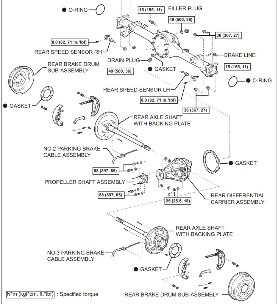

    Does anyone know the torque spec. of the rear differential fill and drain plugs?
    Thanks.

    ..........36 ft/lbs............
