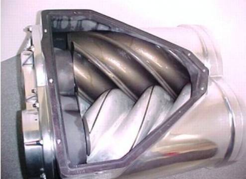

    This type of blower consist of a male and female rotors right? Instead of the symmetrical roots design? More efficient?

    I would love to screw twins! Would this make sense for a daily driver application?

    yeah, male female not a roots type at all. 6k rpm launch, 9,500 thru the lights. its the JC auto glass dragster, the car starts burn out at the 2min 40sec mark it blew the tires off 1/2 track. Div tracks dont have alot of rubber down for grip for the faster cars so we gotta back them down a bunch
