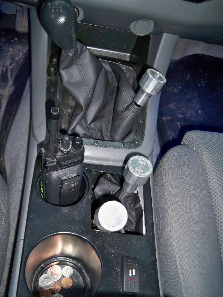

    They do put levers in them......... Ohh wait that was me that did that. :D

    While I wish I could claim credit, I am not the pioneer... clicky.
    I'm actually thinking about a lefty with a doubler. It will all come down to cost vs. benefit vs. intended use. I'm building a reliable 'expo' (I hate using the term because people get touchy about what is, what isn't) rig. Something that I can camp, explore, wheel and enjoy. At that point a doubler and all that will be too much overkill. Time will tell what is in store.
