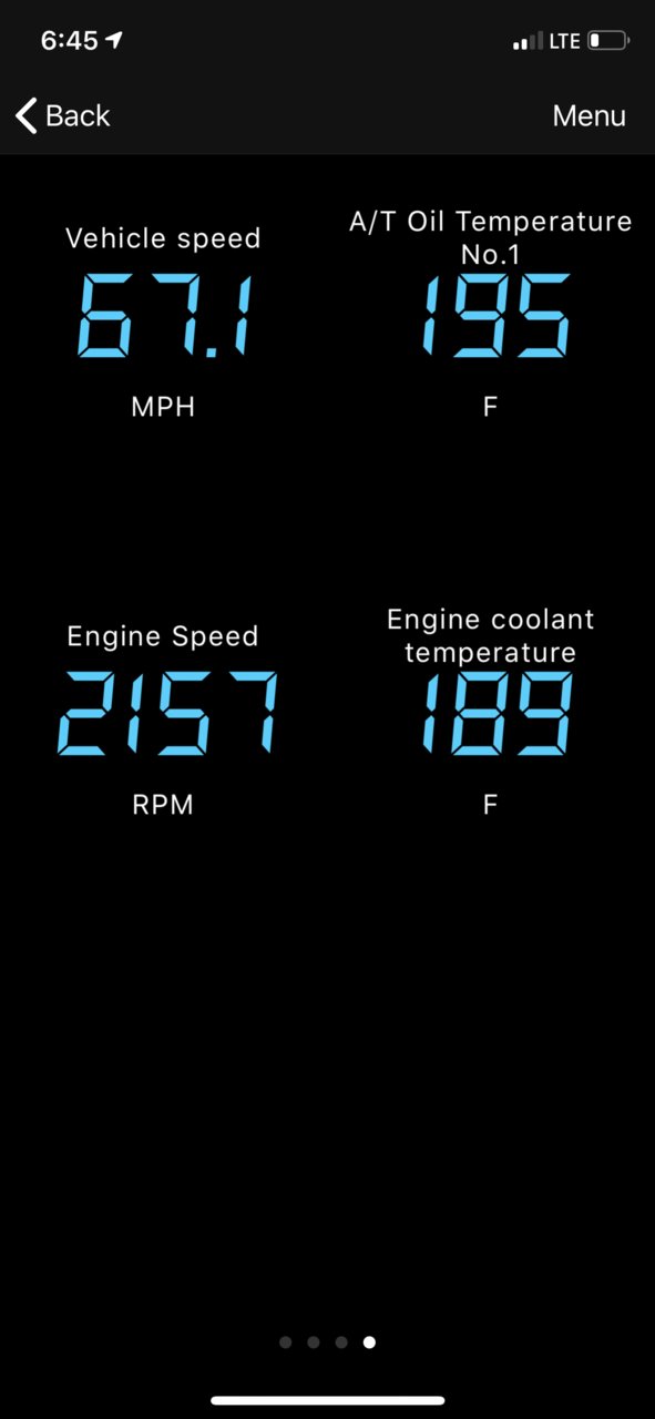

    I use OBD fusion. I like it because I can control when I connect to the app. I paid the extra $10 for the Toyota add-ons that gives you two different automatic transmission fluid temperature readings as well as a million other things...
    All you need to do is purchase a $20 bluetooth reader and then pay $10 for the app upgrade and you're good to go...
