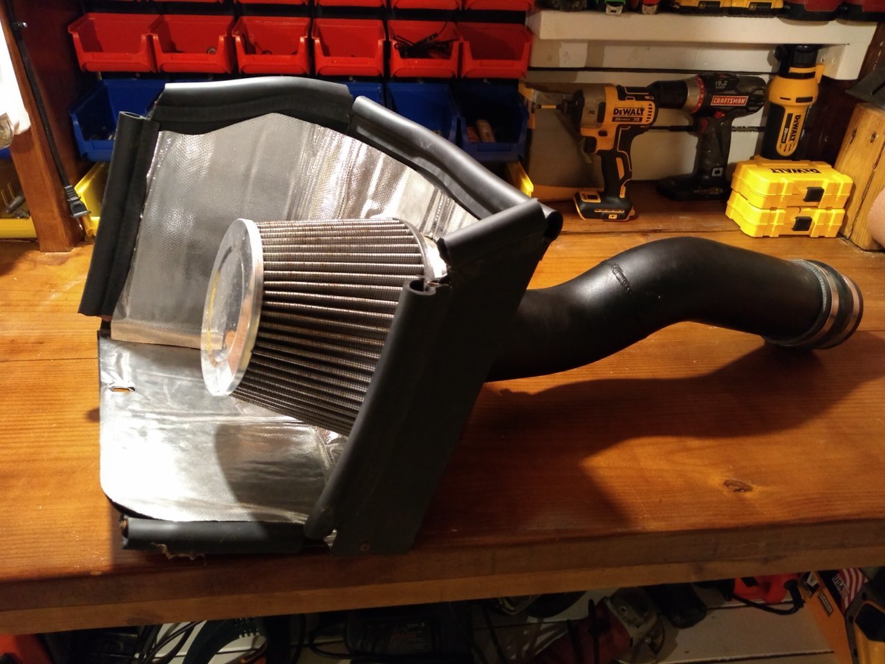

    2016 trd offroad
    Will give mine away for free.aftermarket intake.dont know what make it is.you pick up live in Huntingdon pa.

    Your basically paying for the noise it makes.

    This is a little known "issue". Not really an issue though, stock intake doesnt make the noise loud enough to hear from the cab due to the resonator and closed box design. Open boxes dont muffle the sound and you hear the intake draw some air when you turn the wheel. This happens on stock trucks, you can hear it if you listen with the hood open and someone steers for you, especially after the truck reaches operating temp and the rpms are lower at idle. Power steering pump use causes an increase in RPM temporarily and the clunk is made from throttle opening more and air being drawn into the intake. No harm or need to worry, sounds like the techs came to same conclusion.
    Also explained well here: https://www.tacomaworld.com/threads/popping-noise-when-turning-front-wheels.479062/#post-15453498

    You were right IMHO. Because it wasn't the intake itself wasn't making anything 'work harder' at idle, or anywhere else.
    Suspect the OE intake muffled what you were hearing. A bit of PS load from screwing your tires into the ground at idle likely created a step up in the idle speed from the PS load on the engine. That's an ECU function that might crack a touch more throttle in your drive by wire system.
