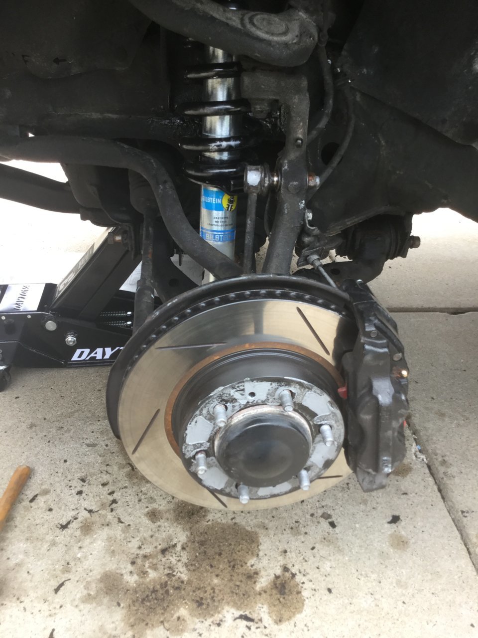

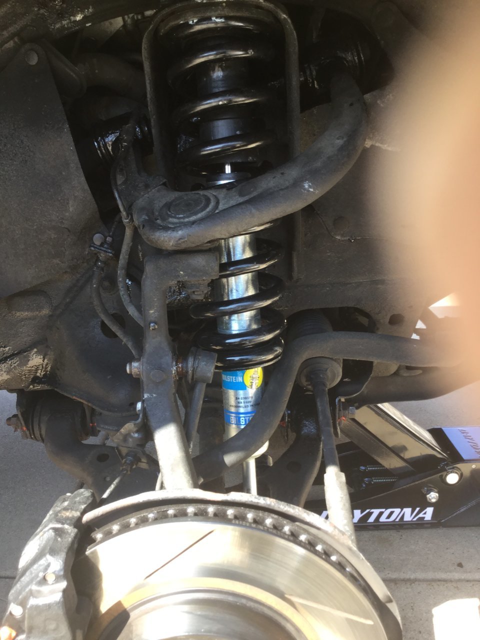

    Front shocks installed OME 884 and bilstein 5100,

    make sure to loosen the UCA bolt at ride height, bounce the truck a few times and re-tighten.

    okay will do that

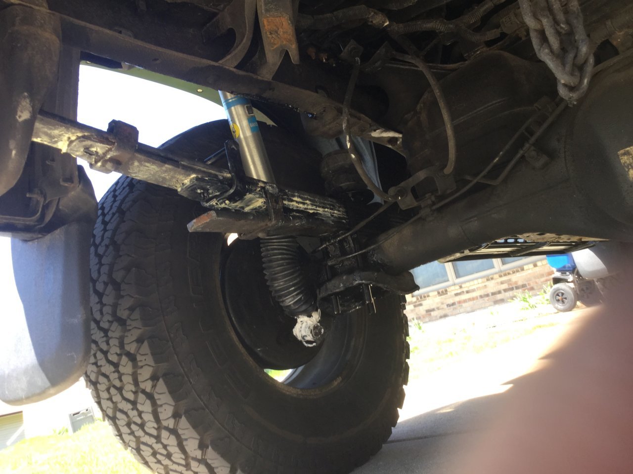

    Got my rear 5125 biltstein put in. And deavers f85 mini 3 leaf put in. All done for now
