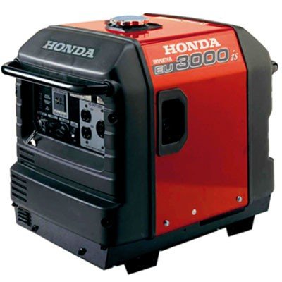

    The lights inside the trailer are all LED's. I have a generator, a 3000 watt Honda that's so quiet you can barely hear it 30 feet away, and can carry on a normal-voice conversation while standing next to it. I'll take it along on some weekends, but only to use during the day to recharge batteries. Star parties are fairly quiet affairs, and even a quiet generator like the Honda wouldn't be appreciated (or usually permitted) at 2 or 3 in the morning.
    I'd go completely DC if it weren't for having a couple of items with voltage requirements other than 12VDC. My laptop, for instance, runs off 15VDC on its internal battery, and that only lasts for about 3 hours when running a guiding program. It's much easier to keep it plugged in on 120VAC, so I'll use an inverter to run it and my DSLR. Astrophotography requires long periods running the computer and cameras and telescope mounts, usually 5-6 hours at least, with total current drain around 10-12 amps. I sometimes have to use dew heaters to keep the objectives free of moisture, and they require 4-5 amps by themselves. Using the generator would be nice, if I could. I do use it at home, my viewing area is too far from the house to run drop cords. Most of my other equipment is designed for 12VDC; when I run AC power, I use 12V converters for all that, and I have a couple of nice Lithium Iron Phosphate batteries, but again, they have a limit before needing to be recharged that is usually shorter than I need for an all-night session.Honda eu3000is.jpg

    The 3000 Honda is the quiets generator I know of it it's far quieter than the 2000 but it is heavy! People have a romantic vision of big battery banks and solar but the bottom line if you need heavy power at night the moon ain't going to cut it.
