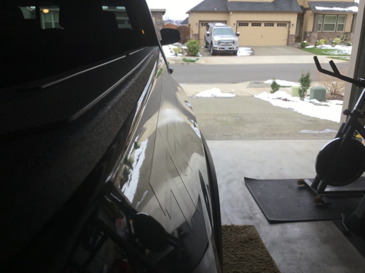

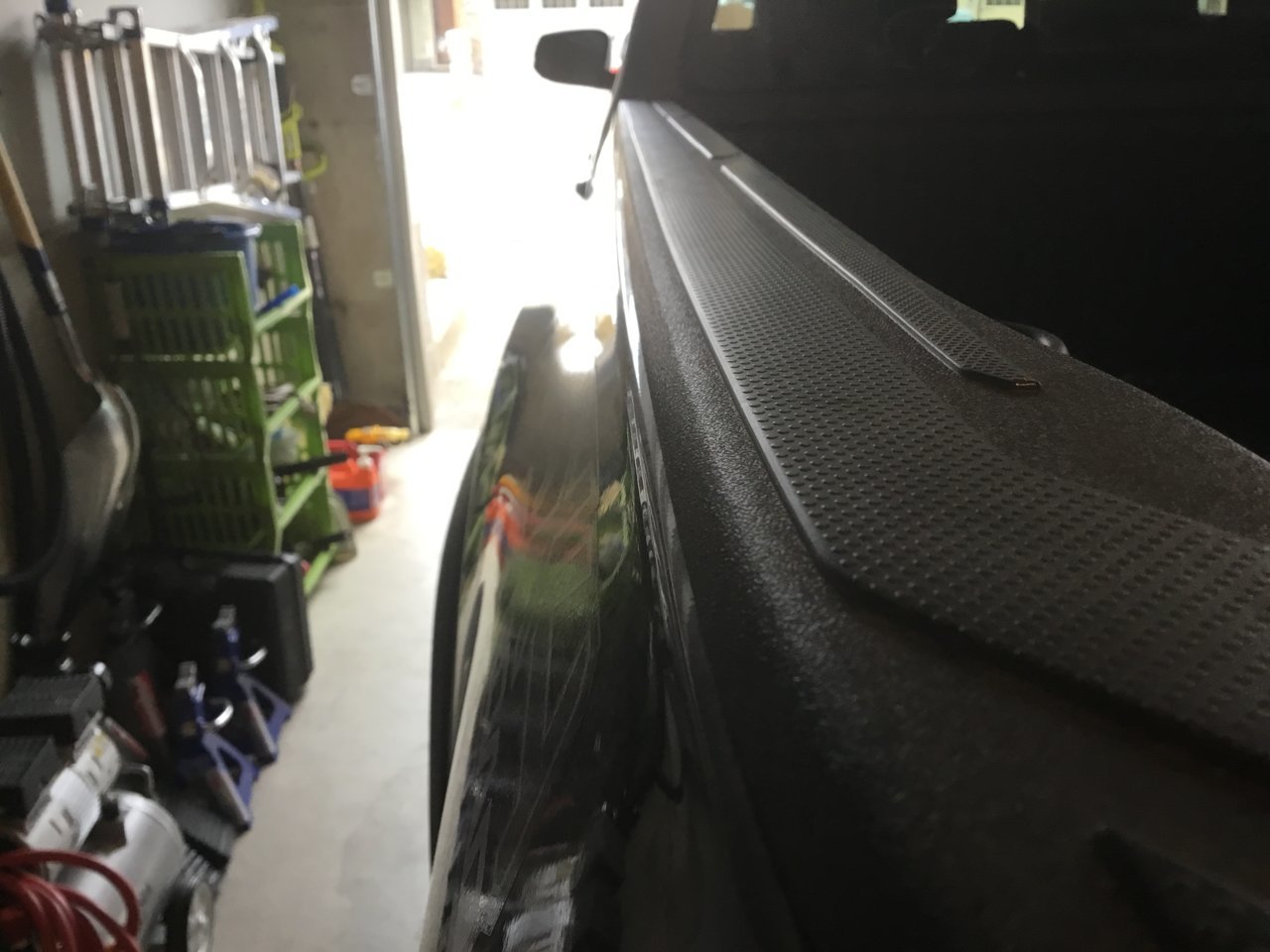

    My bed was way off with one tire (Wildpeak!) appearing to stick out more than the other.
    The bed was positioned off center and crooked from the factory.
    No, “trying to realign the bed”, just do it. It’s very easy.
    Loosen the bed bolts and it’ll slide around by pulling outward at the top of the rail.
    All lined up. 2/23/18

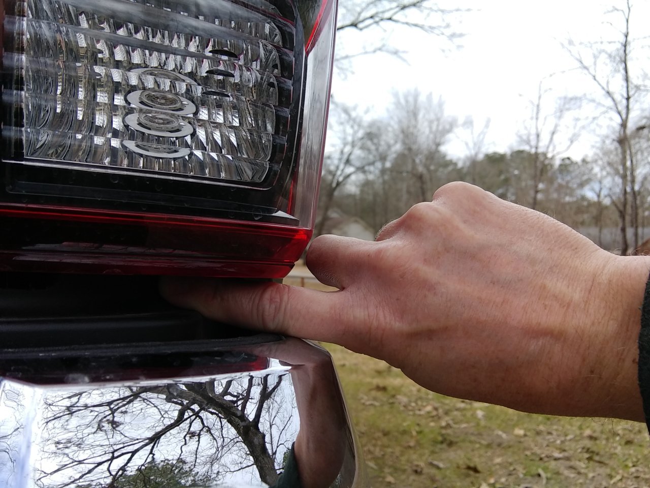

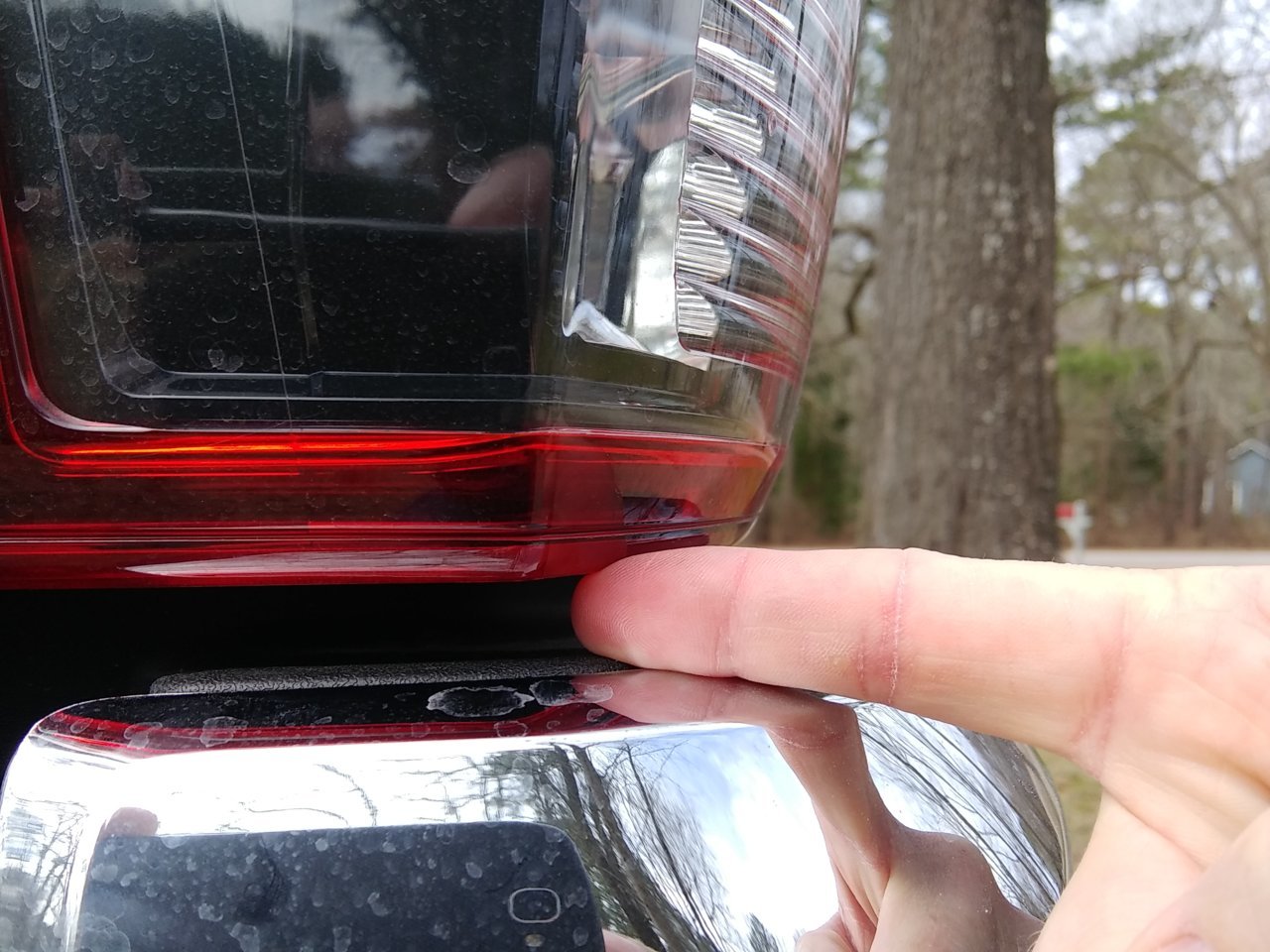

    You mean like this?
    Waiting for warmer weather to figure out how to shim this up.

    Align the bed to the cab and then the bumper to the bed. Not too bad to do. The smaller the hands you have the better ha for the bumper that is.

    The forward and aft gap on the sides too. To adjust, you gotta remove, black center cap and loosen/tighten four 12mm? bolts.
