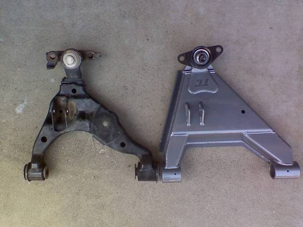

    The problem from my understanding and pretty thorough explanation from Dustin over at Dirt King when I talked to them about it is that the stock bushing pressed into the factory lower control arms have a lot binding force to them upon flex. The primary reason Toyota used them was to reduce and avoid transmitting a lot of NVH back to the steering wheel and to maximize ride comfort. That's all fine and dandy, but I could see that same exact binding being a huge problem when pushing the arms during spirited off roading and causing additional stess at the welds of the eyelets those bushings are in place in. You eliminate the binding at the source by replacing the bushings, add greasable zerk fittings and gusset those areas known to break and you just nipped the issue right at the bud.
    To answer the OP's question, there are several benefits to upgrading the LCA's. If you already have UCA's you will benefit from even more increased articulation out of the fact that the lower is now fitted with a uniball. Of course that may depend a lot on the type of shock you are running as well. Another benefit would be added strength. You are upgrading from a much thinner walled steel control arm from stock to a much thicker much beefer (yet surprisingly, not much heavier) walled steel control arm, with better reinforcing and gusseting in the key areas that stock arms are known to be weak at if pushed hard enough. Additionally, because of the fact that you are now using much better and thicker steel on the control arms, this opens up the ability for you to use hydro bumps. I'm a personal fan of them, because they serve almost like a short shock, without the increased stiffness in ride unlike a secondary shock which would change your ride dynamics entirely and you would most likely end up hating if you still want the truck to be streetable and have good manners.

    Comparison between stock and Dirt King LCA's:

    This all makes perfect senses guys thank you. It's not a neccessary mod for me, but there is definitely no harm in replacing them if I can .
    12TRDTacoma, thanks for the complete answer and clarification, also that stronger lighter steel doesn't suprise me for the cost of the things. It's probably a steel alloy mix that has a stronger elasticity than normal steel and weighs lighter. So more material same weight, and I bet it's probably triple the strength with the design and material choice

    If I remember correctly. I believe the box that was shipped out to me with both UCA'S/LCA'S weighed overall less then 40lbs. The material they use if I can recall right is 304 stainless steel. Though I'm not sure they use that material throughout the entire LCA. No problem man! I'm here to help! :)

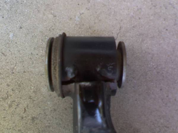

    So this isn't the first weld I've seen pull back and rip the stamped metal like a banana. This is the forward lower mount on my factory LCAs. Replacing them with factory but second guessing and considering way-too-expensive aftermarket options
