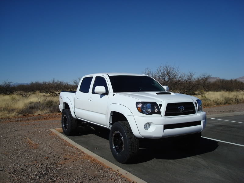

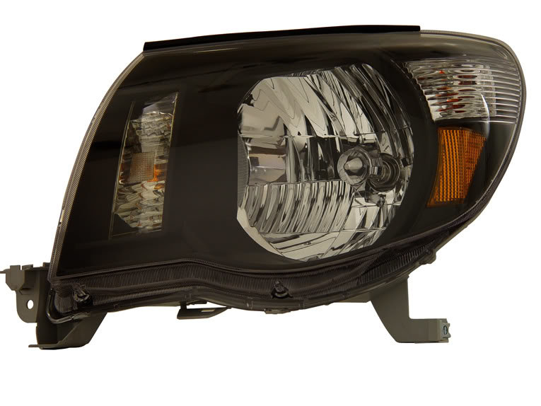

    I bought these ANZO U.S.A. headlights from AutoAnything
    Went around all edges and openings with this just for extra protection
    And after almost 8 months, they still look great!

    Still have these lights...any problems?
