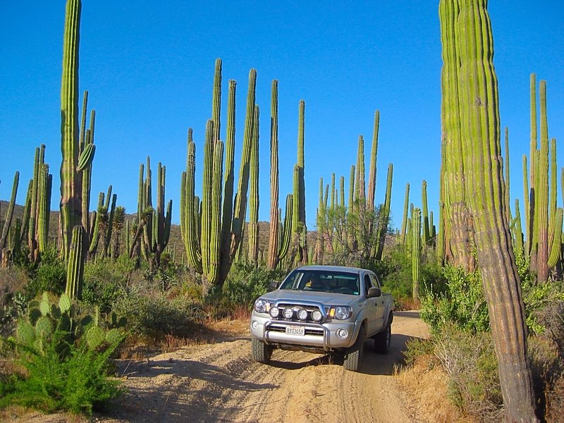

    To see at night, off road, in the desert... There are things hiding in the dark! LOL
    It's an addiction, I think? I hardly ever drive at night when camping or vacationing in Baja!

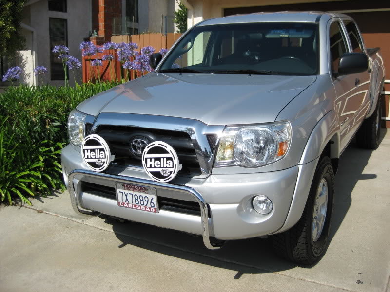

    First, it started with two (Hella 100 watt halogen pencil beams).
    Next, I added two Kragen 35 watt HID Euro beams, and converted the Hellas to HID.

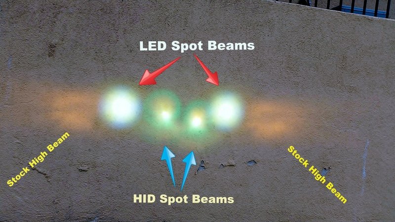

    In 2016, I got turned onto these Cree 60 watt LED lamps... they are insanely bright!
    First, I got two spot or pencil beams and replaced my two Hella HID pencil beams:

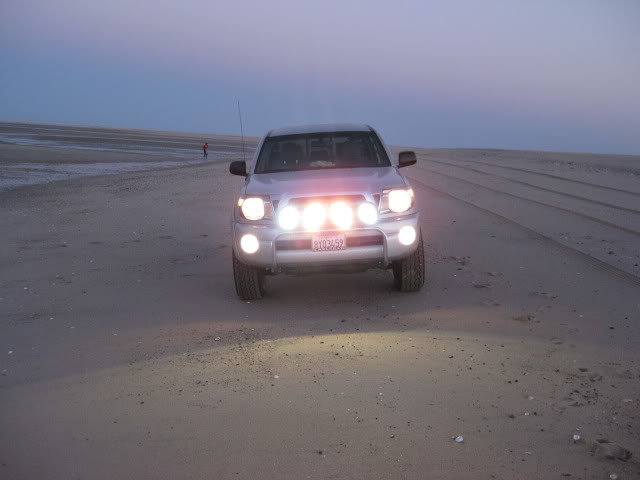

    My final lighting mod, all four Cree LED 60-watt lamps, 2 are pencil beams and two are driving beams:
    Turns the night into day!!!

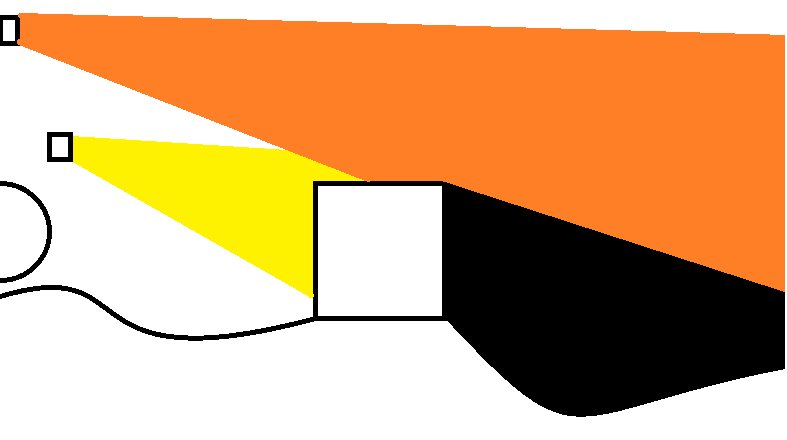

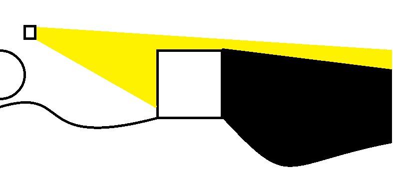

    And IRT the bro-zillas out there with roof mounted light bars, there is actually a purpose (or was). The issue with bumper level lights are they throw very long shadows and it’s hard to tell a shadow from a deep hole. Having a roof mounted light pointed down gives your light throw a better angle to see behind rocks and disseminate depths of holes. Ive attached my super-duper paint skilz pics to help illustrate this. Not my best work but I think it gets the point accross.
    Bumper Level throws long shadows :(
    Roof mounted throws shorter shadows :)

    The darker the shadow, the deeper the hole!

    Good info on the roof mounts, there is some logic to the madness.
