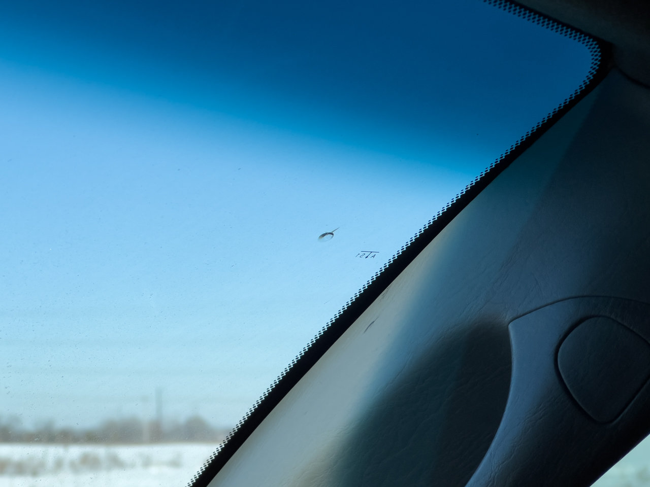

    Not so fun: A f@#$% Kia Soul blasted me with a huge rock and chipped my windshield. Not spreading yet but likely getting this fixed come springtime. I think there are a couple more chips too but those have been there since day 1. All I can say is I've had two chips/cracks in my lifetime: this one now, and one on my previous Subaru that I traded on the Taco. Both use the same type of glass and both (to my knowledge) are known to chip more than other manufacturers. Not happy, but compared to people with GMs blowing up engines in 500 miles, Fords catching on fire, and Chrysler being...well, Chrysler...if this is the worst quality defect we have I'm okay with it.

    3" lift? A.R.E cap 285/70/17 moto metal 955 17x9
    I would pop over Safelite and get that epoxied

    That's the plan. It's on my ever-growing list of stuff to do come springtime (or if I see it start spreading). For now I'm not losing sleep over it.

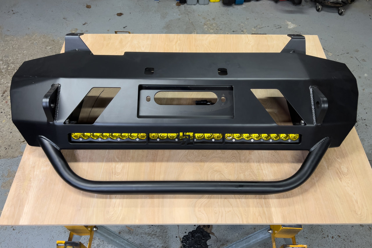

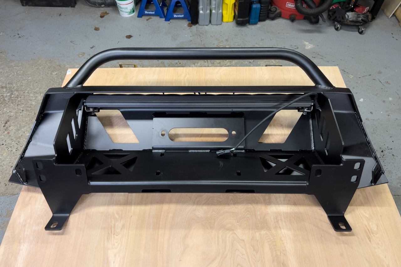

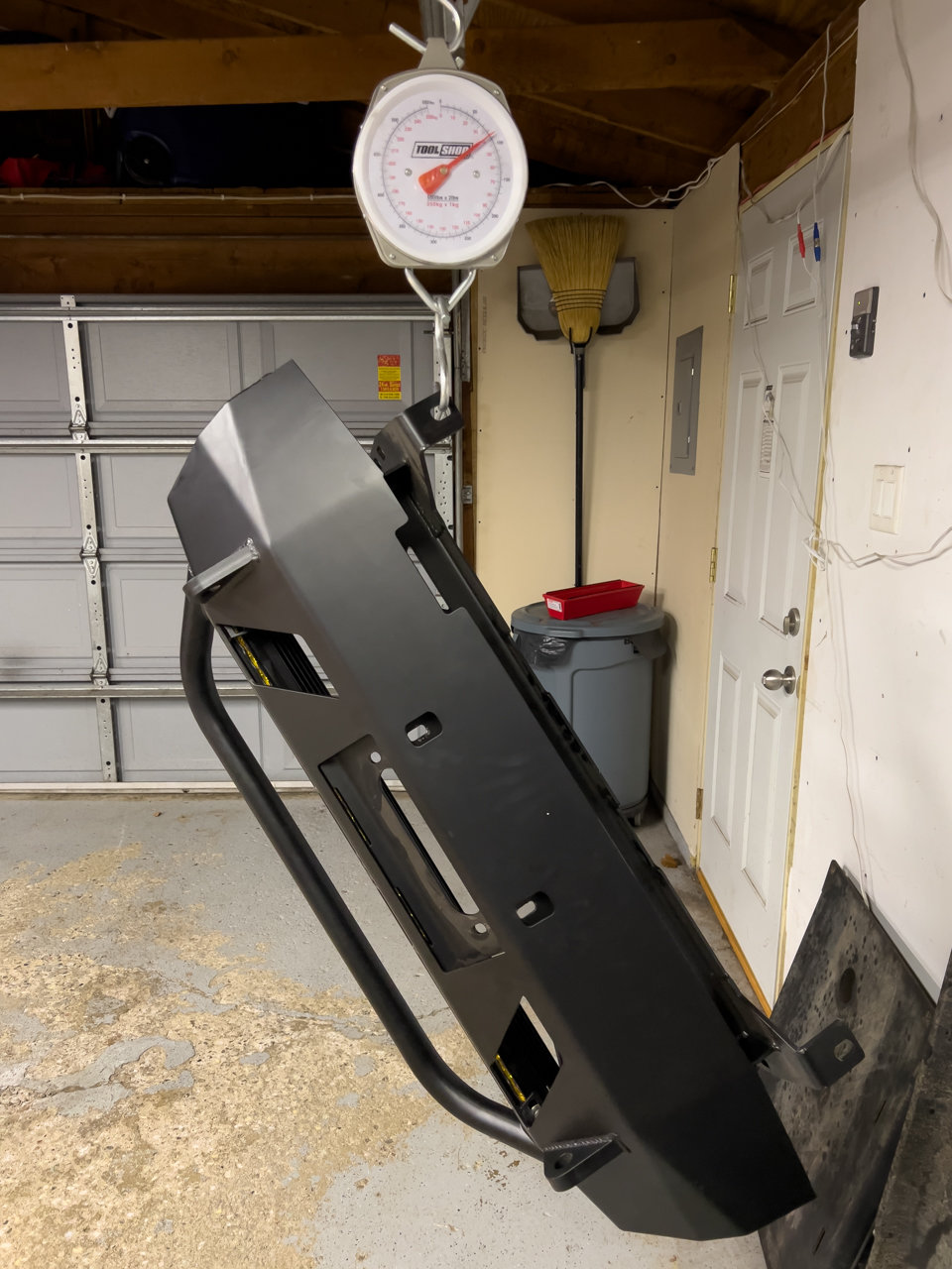

    UPDATE 2/9/23: I GOT BAMBOOZLED, THEY SOLD ME A 3RD GEN BUMPER AND NOT THE 2ND GEN MODEL. IGNORE ALL THE JOY BELOW, I'M BACK TO SQUARE-ONE AGAIN. FML...
    UPDATE #2 on 2/10/23: ChiTown4x4 is being pretty cool about this and taking it back on return. Supposedly sending a local delivery driver to pick it up Monday 2/13. Will update later once it's over.
    UPDATE #3 on 2/13/23: ChiTown4x4 took back the bumper and refunded me with no problems. Joe, the owner, picked it up from my house himself. Great guy and I will have no hesitation to work with them again. I have also reached out to C4 Fabrication via email who helped confirm which bumper I had and they offered me a discount on a full bumper which for now I am passing because I want one of these lo-pro models. Going to keep emailing them every few months until they get sick of me and agree to a limited run group buy or something LOL.

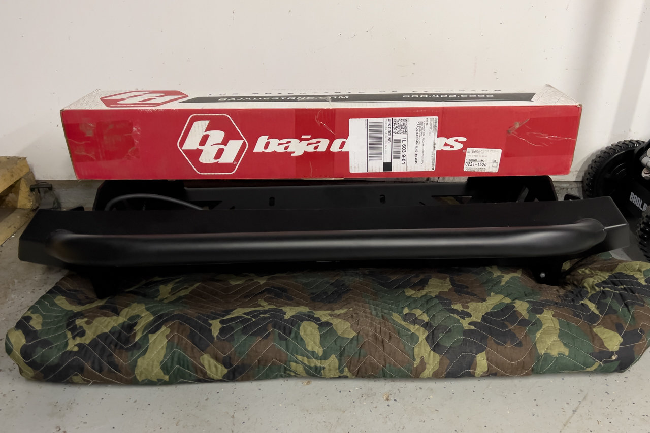

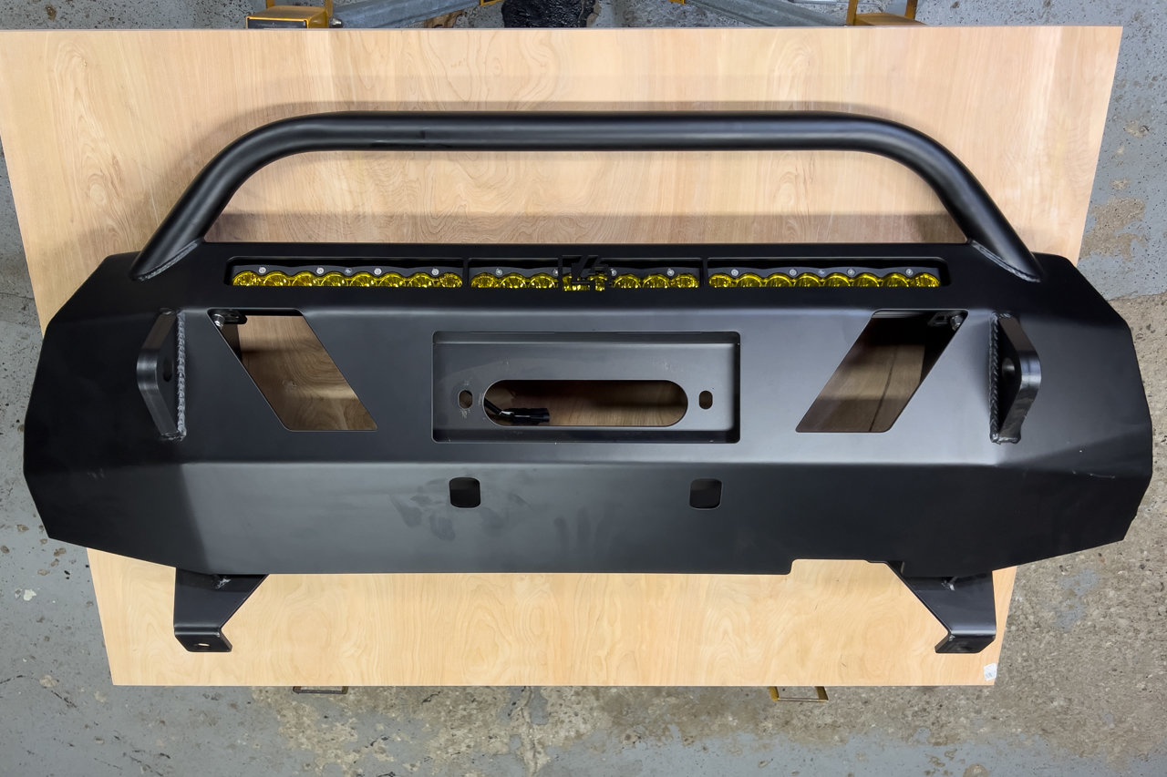

    02/06/23: So this happened. I totally did not plan for this to happen. My bank account totally did not plan for this to happen. This is a crappy photo...what is going on here? As they say "no good deed goes unpunished." From time to time I have been searching Marketplace, Craigslist, and other classifieds to find a camper shell for another TW member. Last friday I stumbled across the exact @C4 Fabrication lo-pro bumper of my dreams, and it came with a @Baja Designs S8 30" driving/combo lightbar (703013) which is also the light of my dreams. Why did I do it? Because C4 doesn't make this bumper any more, and I wasn't able to persuade them last year for a group buy because they are super busy. Have to strike when the iron is hot so here we are.
    (PS - Shoutout to @Hyland33 and his excellent build thread for making me want it, ever since seeing his great photos I haven't been able to convince myself that any other bumper looks quite as good as this.)
    Turns out the Facebook ad wasn't a private seller at all - this was from ChiTown4x4 and everything was brand new. Apparently they bought an assortment of C4 bumpers to have on-hand, and somehow over time nobody bought this one. Again, quite crazy because it seems there is still demand for these and you can't get them. I'm not mad, sometimes the stars align. Initial photos on my makeshift plywood table in the shop, this one from the rear. Pretty self explanatory - it's a low profile bumper with winch mount and light bar slot.
    Another view with it flipped around, though still upside-down. Very hard to take photos on the bench since I can't prop it upright because it's so damn heavy. That lightbar fits perfect and in my opinion is dead sexy. ChiTown4x4 had a winch preinstalled but it was only an 8k and had wire rope so I declined that. Now I need to buy a winch, possibly upgrade to 650lb springs, adjust suspension, alignment, ouch...
    Silghtly better but weirder view - photo rotated 180°. You get the idea. Not shown here but the powdercoat has a few small blemishes probably from shipping. I'm going to touch up the small spots with KBS Coatings paint over the powdercoat for now and cover anything underneath with Woolwax. Assuming this gets used & scraped up later I will probably blast it clean and then re-paint the full thing with KBS for easier more uniform color touch-ups.
    Just like the rest of my armor, I like knowing the weight. Let me tell ya this thing is waaaaaaay heavier than I expected for a shorty bumper. Pure 100% USDA beef.
    Scale shows approximately 85 lbs but that includes the lightbar. Baja Designs specs that at 6.5 lbs. So more or less the C4 bumper is 80 lbs or slightly more with the hardware.

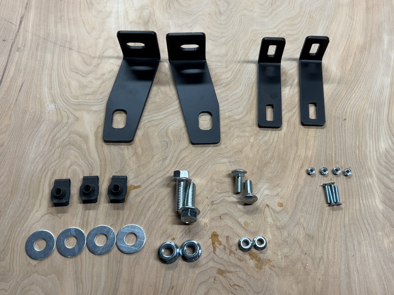

    Speaking of hardware...I got this mixed bag of parts and ChiTown4x4 and they weren't even sure if it's all there. Even the brackets are questionable and might be for a 4Runner but they didn't know. Supposedly it's been on the shelf for over a year and nobody knows what it should have, no pick list from the vendor, nada. I'll have to cross-check against some threads here on TW and maybe call up C4 to see whats missing. (Update 2/8: I emailed C4 who provided a hardware list, most of the hardware shown here is wrong or missing; I'll share in later install post what the right items are once I figure it out myself.)
    I'm like a kid who has seen his Christmas presents but can't open them for months. For now it sits on the garage floor staring me in the face, whispering faintly "buy a winch....install me!...." But that and the suspension changes will have to wait until springtime after all the road salt washes away.

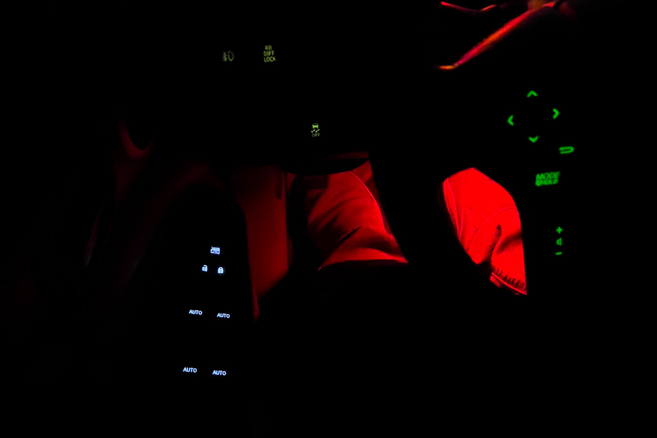

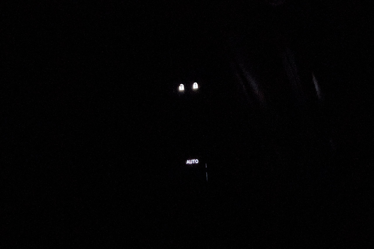

    Saw this post by @AdrenaliNate in the "What have you done today" thread about fully backlit and auto up/down window switches from Cartrimhome and I couldn't resist trying them myself. Pros: they definitely light up and the definitely work for auto up/down. Cons: Switch tactile feeling is...about what you'd expect from parts at the Aliexpress quality level. [Update 10/27/23: Switches have broken in a bit, I very much like how they feel now and no concerns on quality.] Also they don't have red LED color choice so I went with white to match some of the other 2015 colors. However as you can see, I have quite the kaleidoscope situation going on right now. More on that in the future.
    Front passenger window switch, not anything exciting but it lights up now. It is also noticeably brighter than the driver side switch, almost too bright. I took these apart to see how hard changing colors is. Let's just say unless you have skill desoldering extremely small SMD components it's impossible. I used to work at an electronics company and I could do it with appropriate tools but I don't have them at home due to expense. Might have to buy one now and make a small side hustle out of it...
    Interestingly, markings on the packages don't fully match what I purchased. I'm assuming the company Cartrimhome just resells Aliexpress stuff at a markup. Also interesting is that these also fit a 13-18 Rav4 so finding alternatives might be another future option. Sharing the package labels in case it helps anyone later.

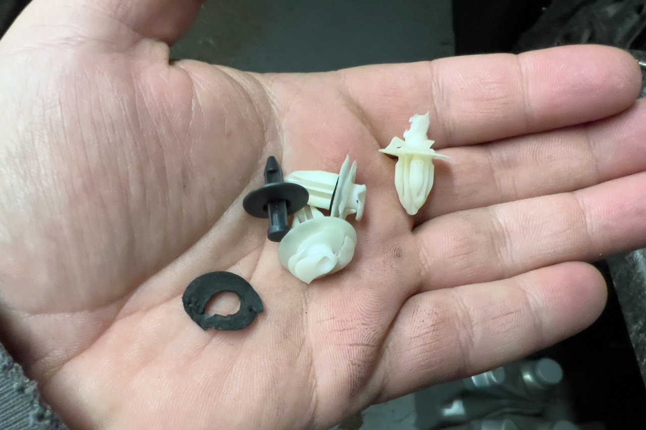

    Changing out the switches isn't difficult at all, however you absolutely 100% will break a bunch of door panel clips. I also broke part of the passenger side trim that the switch snaps in to. Based on how it came apart, I guarantee nobody has ever taken apart my truck since it rolled off the assembly line, so that may have contributed to how fragile all the plastics are. No big deal - replacements are relatively cheap and I will be back in there later for speaker upgrades.

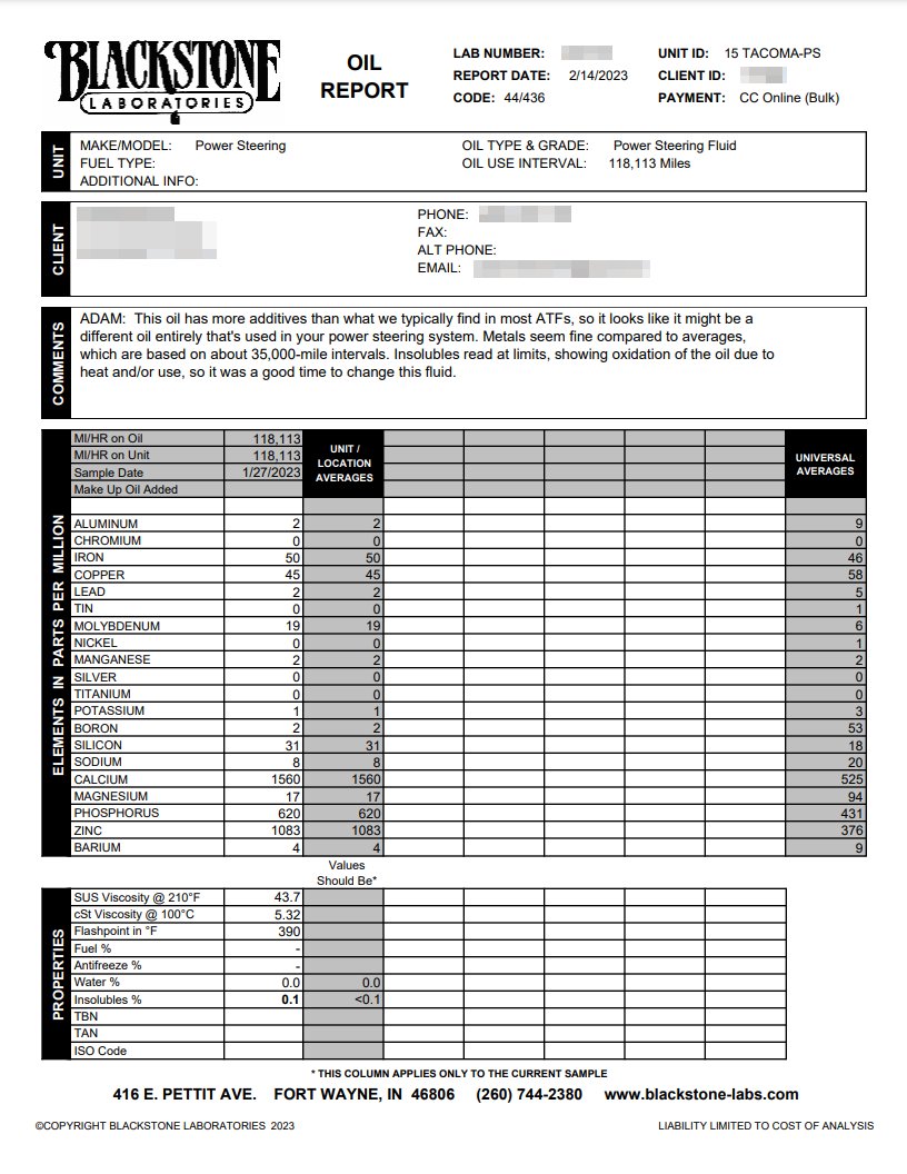

    Received the Blackstone lab results from my recent power steering flush & fill. I'm assuming it was the original factory fluid and there is no doubt at 118k miles it was time for a change. Interestingly the lab comments it isn't what they typically see for an ATF-type fluid, so maybe it's possible the previous owner changed it to regular power steering fluid (which explains the leaks), or maybe Toyota OE fluid uses some proprietary additive pack. Not sure but an interesting data point. It's full of Valvoline Maxlife ATF now and so far that's working well. I might dump that later & move to a thicker viscosity product like the one from Mobil but that task is very low priority for now.

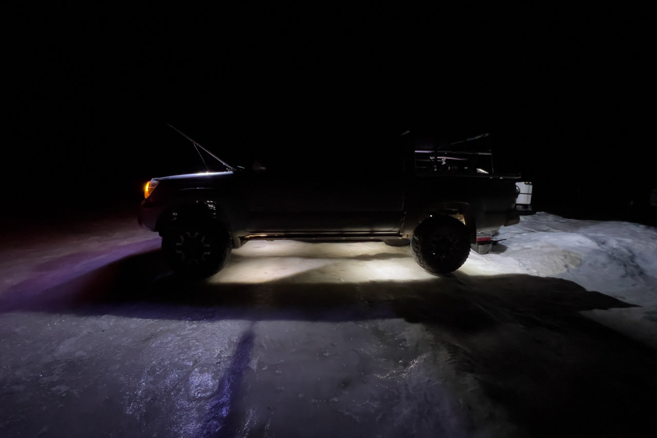

    Pat showing me his awesome rock lights at camp. This has been on my list but have to say this is extra awesome in the winter time.
    Drone shot above camp. Didn't have much light left by the time we arrived so this is the best I could get with limited time in the air.

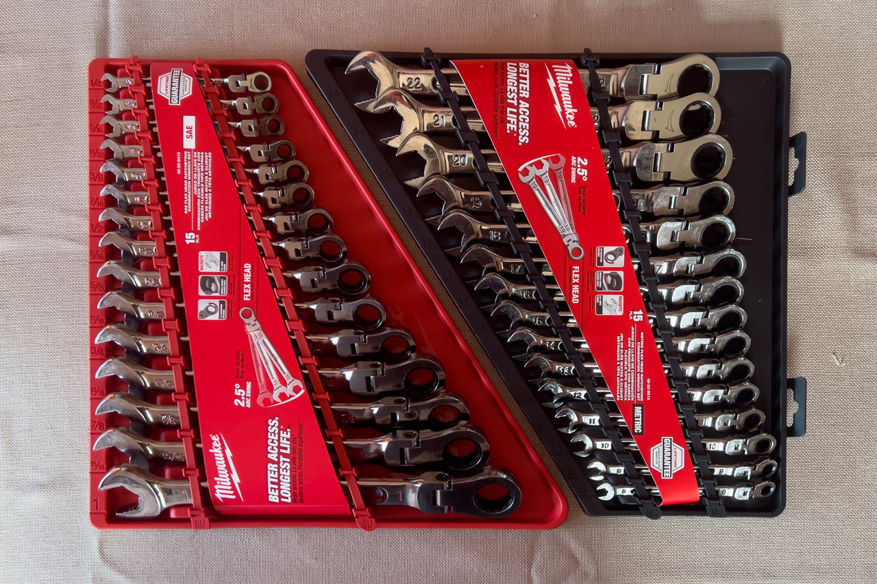

    Not directly related but picked up some awesome flex head ratcheting wrenches thanks to a Home Depot flash sale. Could never justify them before even though they are nice, the sale corrupted me. Hopefully they are the last ones I'll ever need to buy. Definitely a couple spots on the Taco that will be much easier & faster to maintain with these so it's not that I bought them without a purpose in mind. Goes up to 22mm on the metric side which is pretty impressive but I might pick up the 24mm one separately to cover 99.9% of everything on the truck.

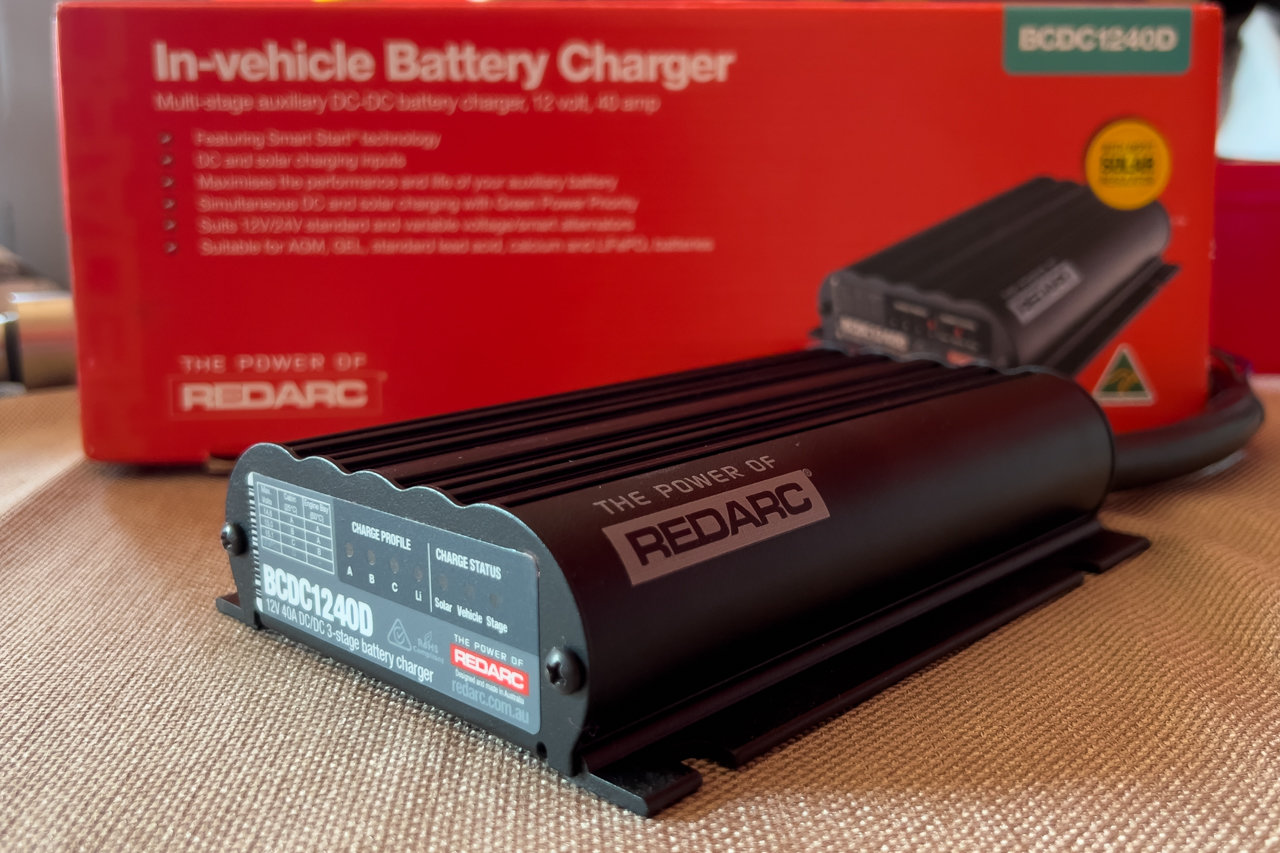

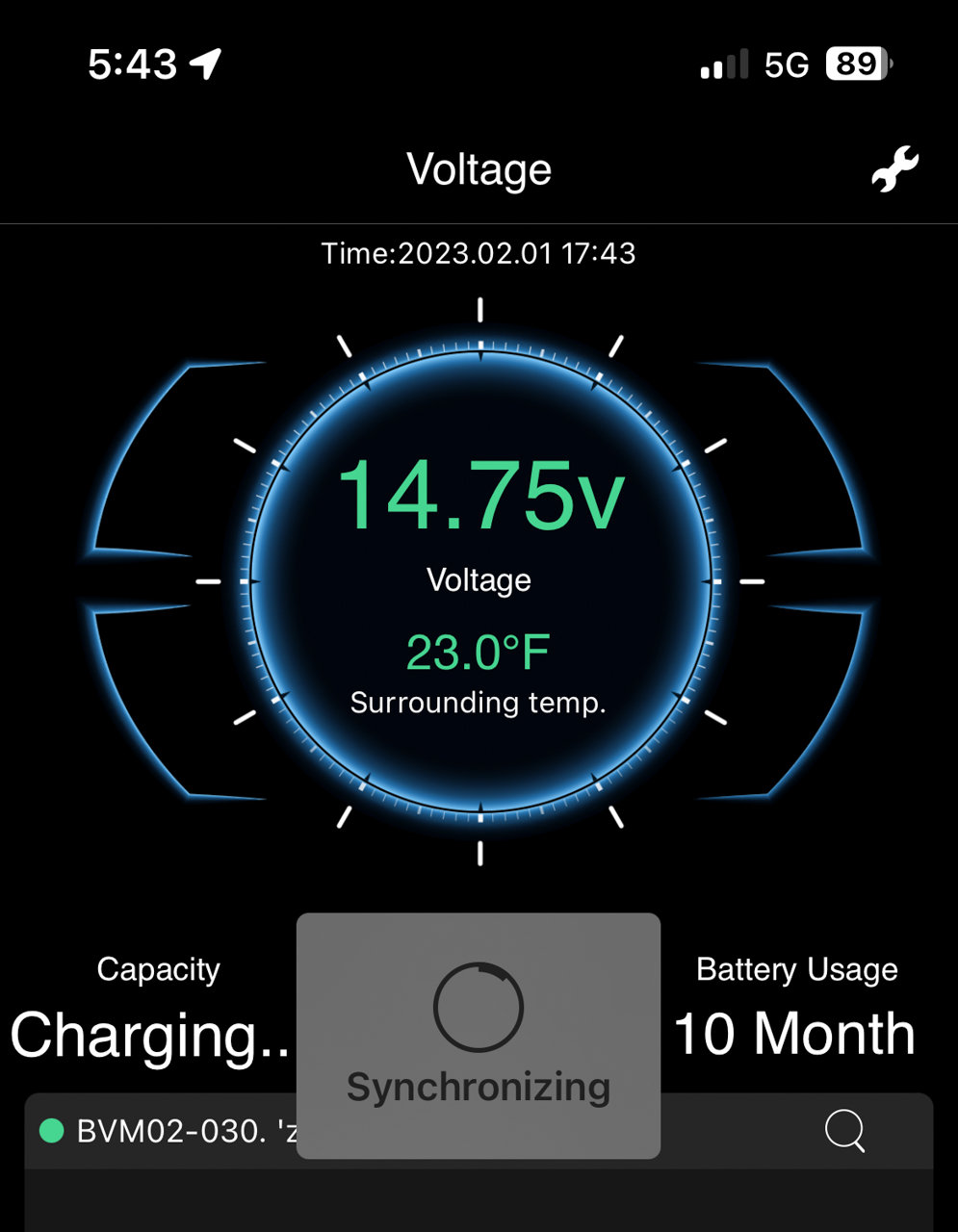

    REDARC BCDC1240D arrived so I can start wiring up the second version of my house battery 12V system. Still deciding how to wire it up, and of course now I need to source more crimp-on wire lugs because I never have the right sizes around. Much more to come on this in the future.

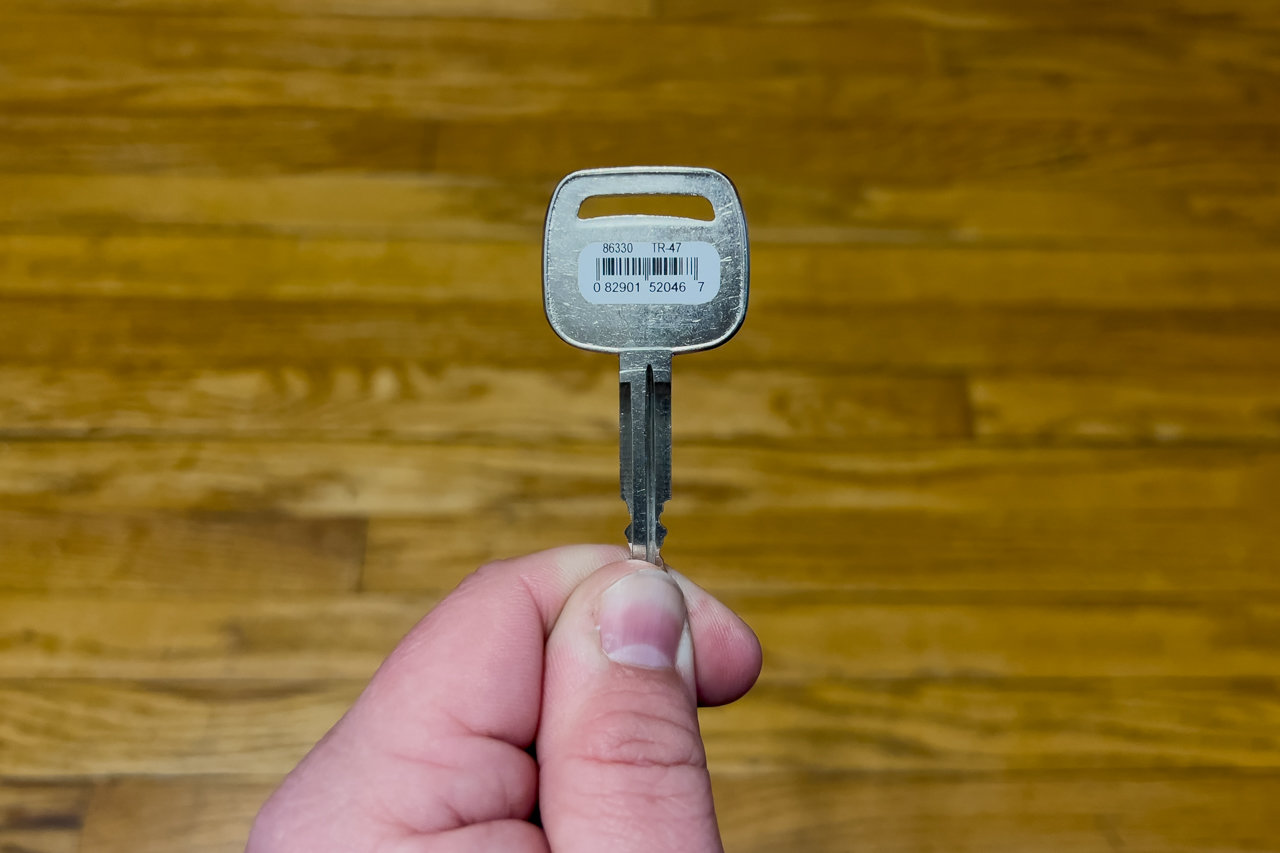

    Sometimes the simplest mods are the ones with the most impact. Had a spare key cut at the local hardware store, this one without the chip. Why? Plan to hide it somewhere on the undercarriage for emergencies where I am locked out. Won't start the truck but if all else fails at least I can climb inside and shelter. Tested out to make sure it works but hopefully I never have to use it. For $3 it's possibly the cheapest insurance you can buy.

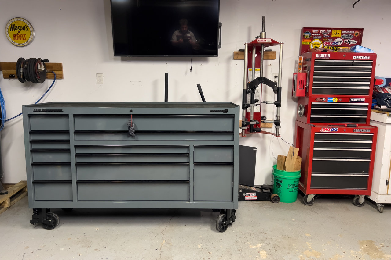

    Towed with the Tacoma for the first time the other day...
    ...and brought home a new toolbox. Finally I'll be able to get somewhat organized and fit all my stuff in one place instead of spilling out of my Craftsman box that I've now outgrown.
    And I bought a 2010 Honda CR-V as a backup/commuter vehicle so that I can work on the Tacoma for mods that take longer than a day and not have to fear missing work. Have a few jobs that I don't want to risk something going wrong on a Sunday so while it does take funds away from fun mods, it is the smarter "adult" thing to do (or so I'm told, it's all cope lol). By the way CR-V forums suck compared to Tacoma World, makes you appreciate this place when you go looking elsewhere.
    Edit: CRV build thread here, don't expect too much excitement.
    sparkystaco and LarryDangerfield like this.

    I'd like to be the first to say I like your box! It's so hot......
    The CR-V is nice to :thumbsup:

    Thanks and thanks! Both are tools purchased with the intent to better work on the Taco, hopefully my plan works out in the long run.

    Bought a rear bumper a while back, today was the day to test fit it. Old one came off pretty dang easy. Hardest part was finding the key to my locking hitch receiver pin, rest of it came apart in like 10 minutes. Will be happy to get rid of the old one which is more or less made of tinfoil and plastic.
    New one either has fitment issues or I am not clear on how this is expected to fit. Seems like it was welded together about 1/4-1/2" too high preventing the needed adjustment upwards and the body lines don't match up. Emailed the vendor to see what's up. Other than the alignment quality is good and weight versus the stock is about even. Gain clearance and no extra weight? Sounds good to me. [Update 7/24 3pm: Vendor says it's normal, hard to match perfect on every truck; I'm good with that. Bumper has been dropped off to powdercoating shop and quoted 7-10 days turnaround]
    More to come soon. Wasn't intending on spending much on parts but need some fixes. My credit card is about to learn the real meaning of pain, ugh.
