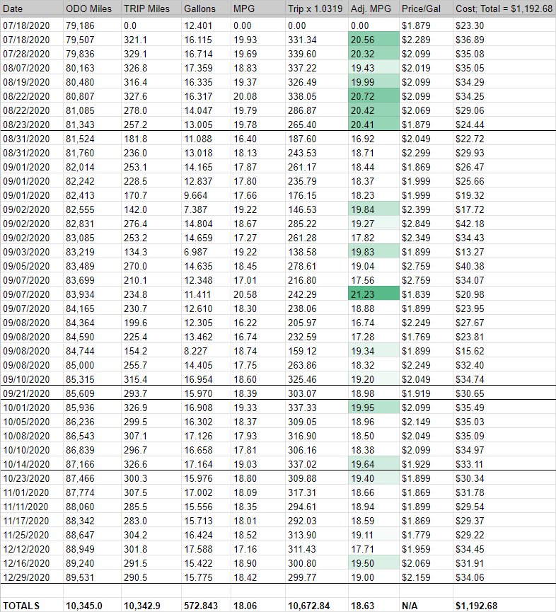

    Over the past few years I have kept my MPG in a spreadsheet (also keep my maintenance, truck specs, and other data there too but yes I am a crazy person). I have done this especially with vehicles that I have put oversized tires so I can get real data versus just anecdotal stuff from the internet. Could I use a service like Fuelly? Sure, but I like being a nerd and tracking my own data. Sharing so others can use as a data point if desired.
    In my case I bought the truck in July and ran 10k miles year to date. I'm running 265/75/16 BFG KO2 tires that are starting to run low on tread. Chalk testing I keep them at 35psi all around. Put on a Leer cap in late August. Correcting for tire size multiplying trip meter by factor of 1.0319. Average this year is 18.06mpg, highest one one tank is 21.23, lowest is 16.74. Use that knowledge for whatever it's worth.
    The horizontal black lines can be ignored but I used them to delimit some of my expeditions. If you notice the big chunk in the middle with a wide variation - that was my drive cross country to New Mexico. I suspect variations highly correlate to driving conditions: lower MPGs where speed limits were higher, some due to elevation, some due to extremely hot temperatures.
