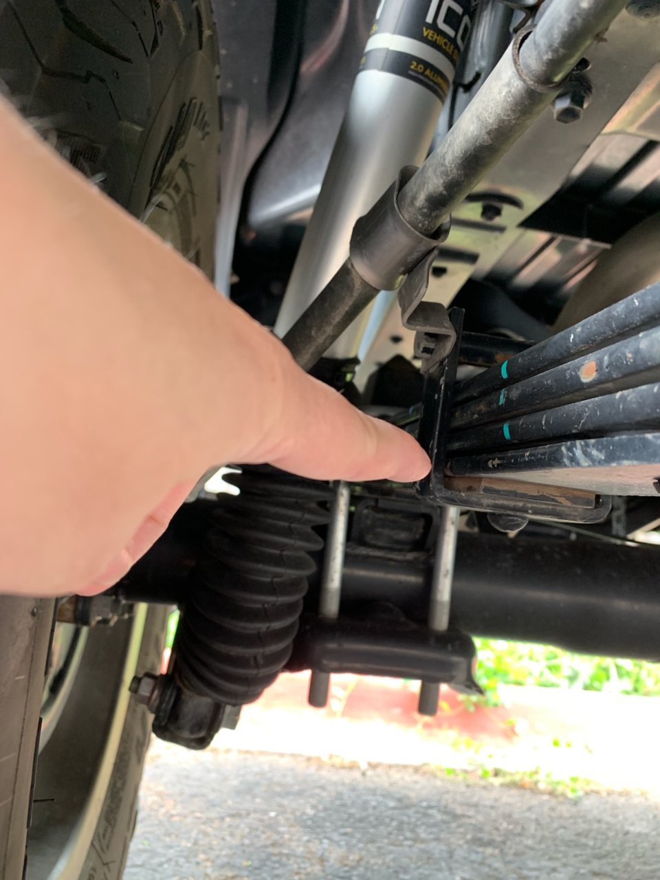

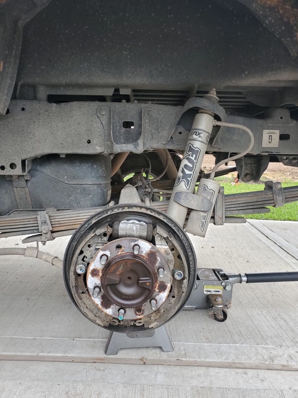

    Wife went down to the dealer to have them show her what is wrong. 1st pic is how they received it. 2nd pic is where they will relocate the bracket once the lines are replaced.

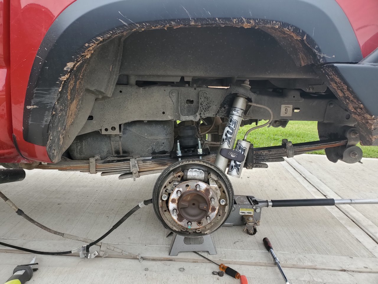

    Here's my E-brake line extension bracket... that still tore my line under off roading flex at Jambo.

    Pic 1, seems to me that wasn't the stock location for that E-brake cable bracket. I don't have a 3rd Gen, but generally Toyota has them low, like Pic 2. The lift installers may have done wrong. I wonder if the driver side bracket is the same.
