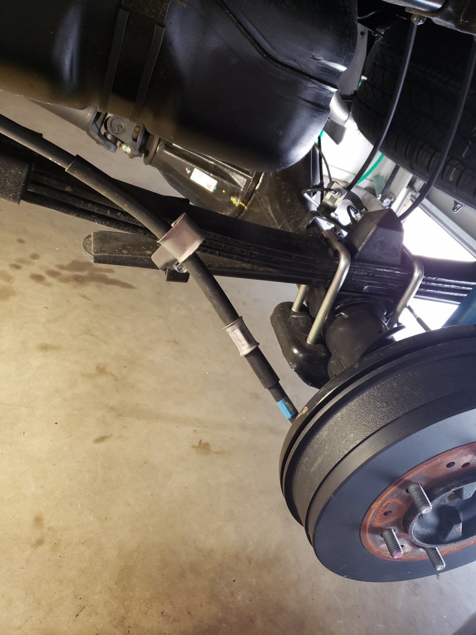

    The kit I used included said block. I didn’t find it necessary but I did change the bracket on the hard line above the axle.
    I had to remove the driver side parking brake cable bracket and use a zip tie. On the passenger side I was able to bend the bracket enough to keep the cable from kinking at full droop.
    I’m surprised a competent off road shop didn’t check everything through the full range of travel. But I don’t have enough information to throw them under the bus. This is exactly why so many mechanics won’t install customer supplied parts.

    So after 1500 miles the problem has returned, stuck in another parking lot with the driver rear tire locking up.
    Waiting a a tow once again.

    Had it towed to a ford dealer (we are out of state, nearest Toyota dealer is 1.5hrs away). Ford tech said that rear drum brake adjuster was all the way out. Thinks when the cold water gets on it and it sits it’s seizing up that brake. He made the adjustment to the brake drove it around, sprayed it with a pressure washer and drove it some more. Seems fine now.
    Idk what to think, just frustrated with 1600 miles ahead of me before getting back home.

    Saw this happen to @Project Recon on the trail. They floored it in forward then reverse several times till it let go.

    Keep some WD40 handy .
