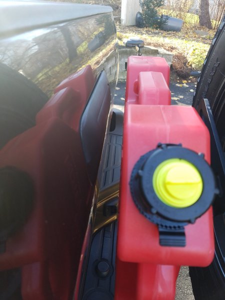

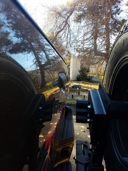

    Here's gonna be the next issue. The high clearance version is supposed to bring the whole tire assembly up 4 inches. Once that happens the there will almost be no room to put the Rotopax handle on the gas can. Let alone the locking mechanism. Look at the pics below and now imagine it up 4 inches higher. So if you notice on our tailgate it is bowed not flat. So the higher the Hitchgate goes the more the rounded tailgate sticks out

    Inertia brother, it's stuffed in a 2 inch hitch receiver with a 90 pound tire and wheel assembly in it. The Rotopax can weighs nothing it's empty

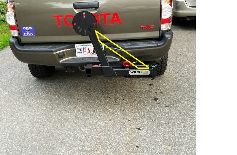

    Also wondering if some bracing in this fashion wouldn't help add rigidity to your version. Would think they'd need to modify the lock pin? or whatever the red handled doohickey is, or relocate it.
    But it would seem rigidity and tailgate contact is a far worse headache (design flaw) than modifying the small parts.
