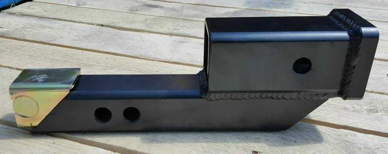

    Thoughts sir. I think he meant put this wedge lock in my 2 inch receiver. Then put the Hitchgate into that instead. And it will definitely move away from the tailgate enough for the gas can. To me I think that would look horrible, and would wonder of legal ramifications if I had got into an accident towing something. And they saw all the cluster of hitches

    How much length does it add?

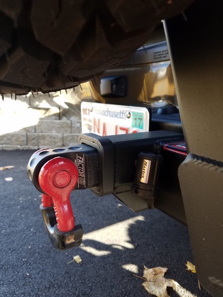

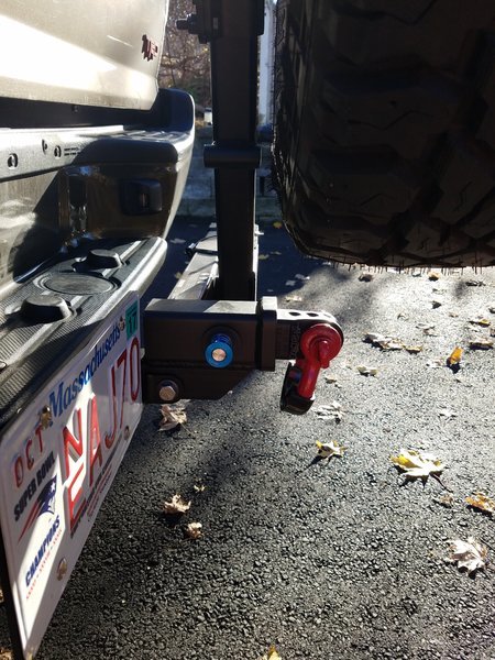

    No idea honestlyBut think about the Hitchgate now coming out of where the red D Ring is

    I dunno.
    Part of the aesthetic appeal is not having 12" of air space between the tailgate and tire.

    does turning tires to black wall out count? How bout added snug top rebel.
    I think they just need to space that hole another inch or so away where the mount attaches to the receiver hitch. Or space the tire away from the truck where the tire is mounted at the top of the gate, or a combination of both.
    And also address the license plate relocation so that it's not having to be removed to tighten the wedge.
    I've been watching since you started the thread, looks pretty functional, I'm waiting to see what the taller version looks like.

    The other quibble is adding an extension will push the load further out on what is basically a lever, so it'll be more prone to flexing, particularly at the tire where the weight is, since essentially they're using 3 separate levers in their design.
    One in the receiver, the other to the hinge, the other to the mounting plate. Having that many pieces and no gusseting is flex for days.

    No sir. Not more.
    Same tow rating all the way around.
    Our SoloXL model has a 3" longer receiver shaft...it's horizontal support arm is also 5" wider. Not sure if it is too wide for the Tacoma.
