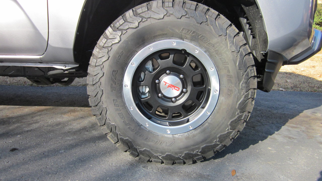

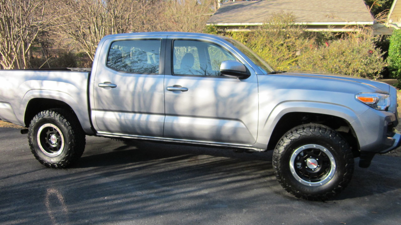

    I went from the steel wheels to the TRD bead lock style wheels and had to get new TPMS sensors and the washers and nuts to mount them as well as lug nuts for the alloy wheels. The nuts and washers from your old TPMS sensors can be used to mount the steel wheel sensors but as stated you will have to be careful using the steel wheel sensors, the angle is wrong and will probably be damaged when changing the tire next time. I chose to not reuse the TPMS nuts and washers on the new wheels so that I could sell the steel wheels and tires as a complete set on Craigslist. New tires 013.jpg New tires 004.jpg
