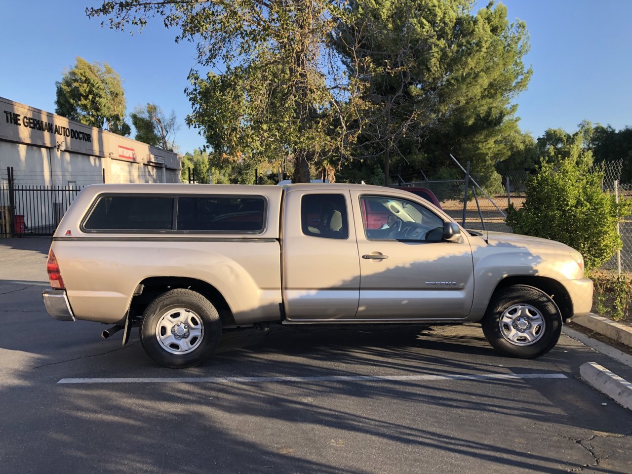

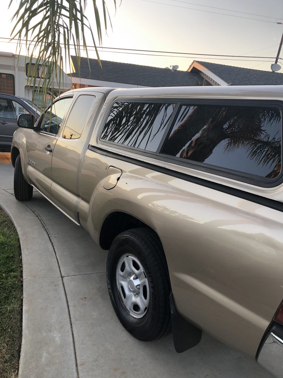

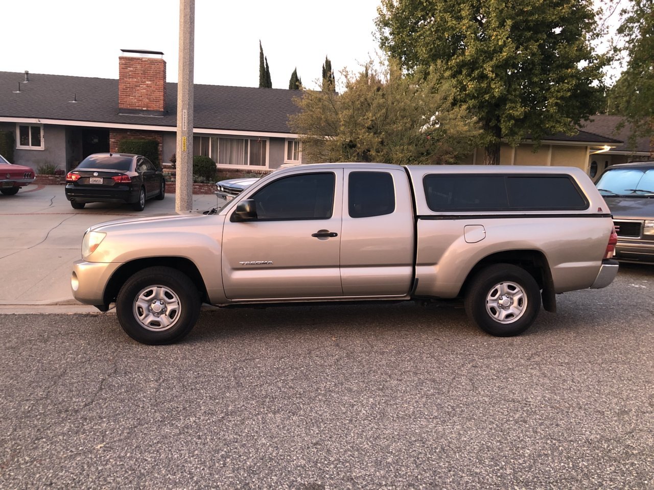

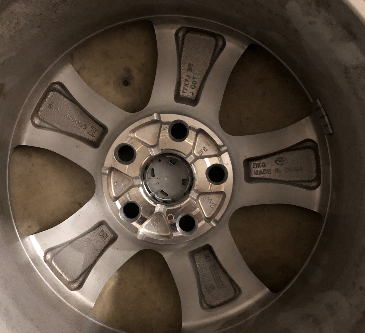

    I wanted to upgrade my wheels on my 2006 Tacoma 4 cylinder with 2019 RAV4 OEM wheels. Is there any issue with the Tacoma being rear wheel drive and the RAV4 being front wheel drive?

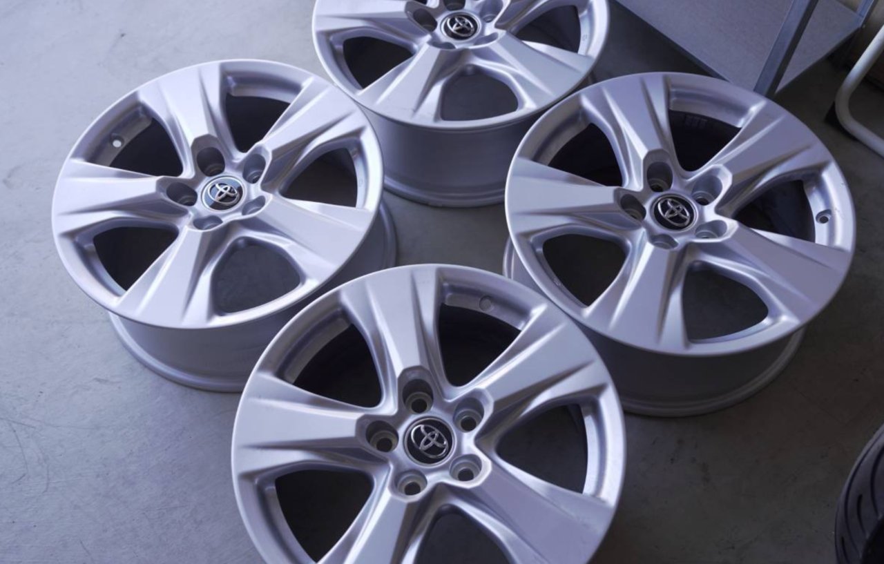

    Here are the wheels I'm looking to purchase, 2019 Wheel RAV 4 Wheel Alloy 17X7 5X114.3 35mm 5 Spoke OEM. It looks like they should fit.
    What lug nuts should I use?
    Also, what tires would you recommend for best drive and look.
    This is my first Tacoma and so far I've learned a lot from the wise Tacoma owners on this site. Thanks, D

    They will probably work.
    The critical part is to make sure they clear the front calipers. Unless you've seen the exact style wheel on another 5 lug I would test fit it first.
    You'll need flat washer mag lug nuts like these for those wheels.
    As far as tires, 235 75R15 is the biggest tire recommended for use with the original 15" steel wheels.
    The equivalent 17" tire size is 235 65R17 which should fit without clearance problems.

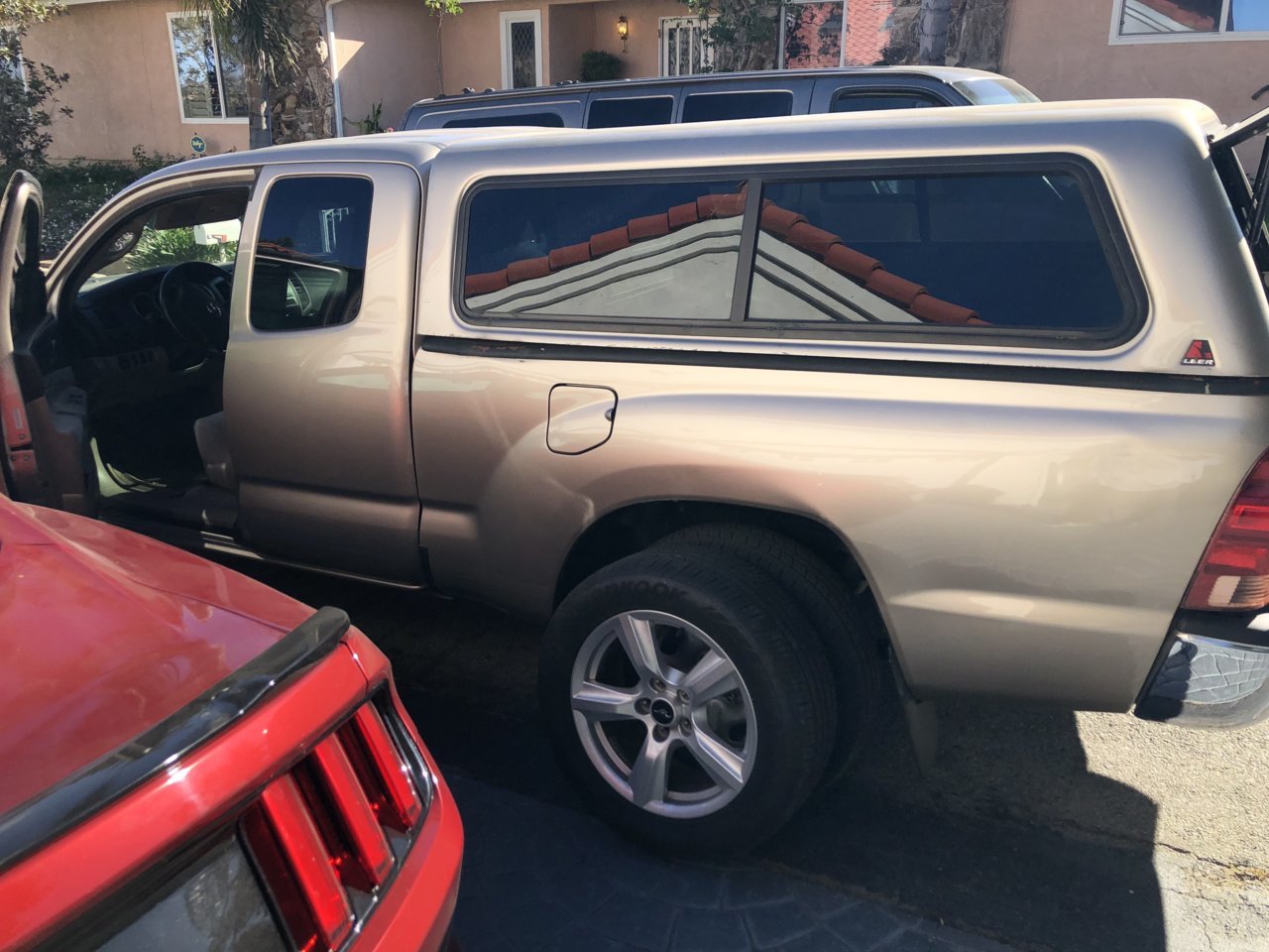

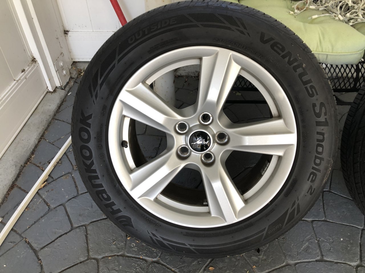

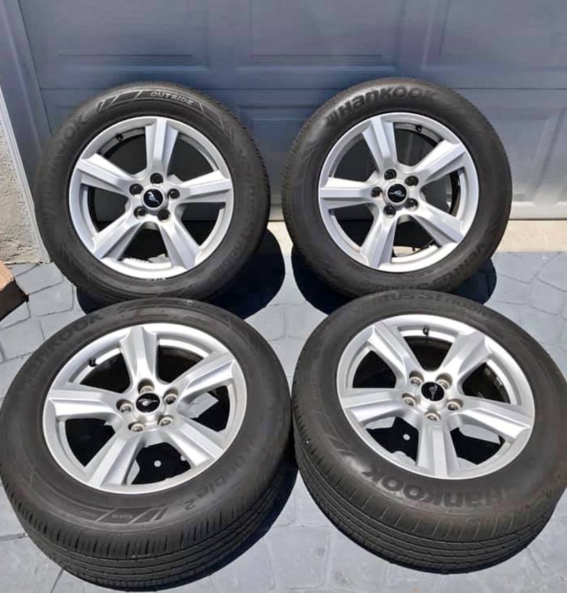

    I'm looking at a set of 2016 Mustang Rims this am that I'm hoping will fit well to upgrade the truck. The rims and tires size are 235/55R17.
    I also just had the front windows tinted.

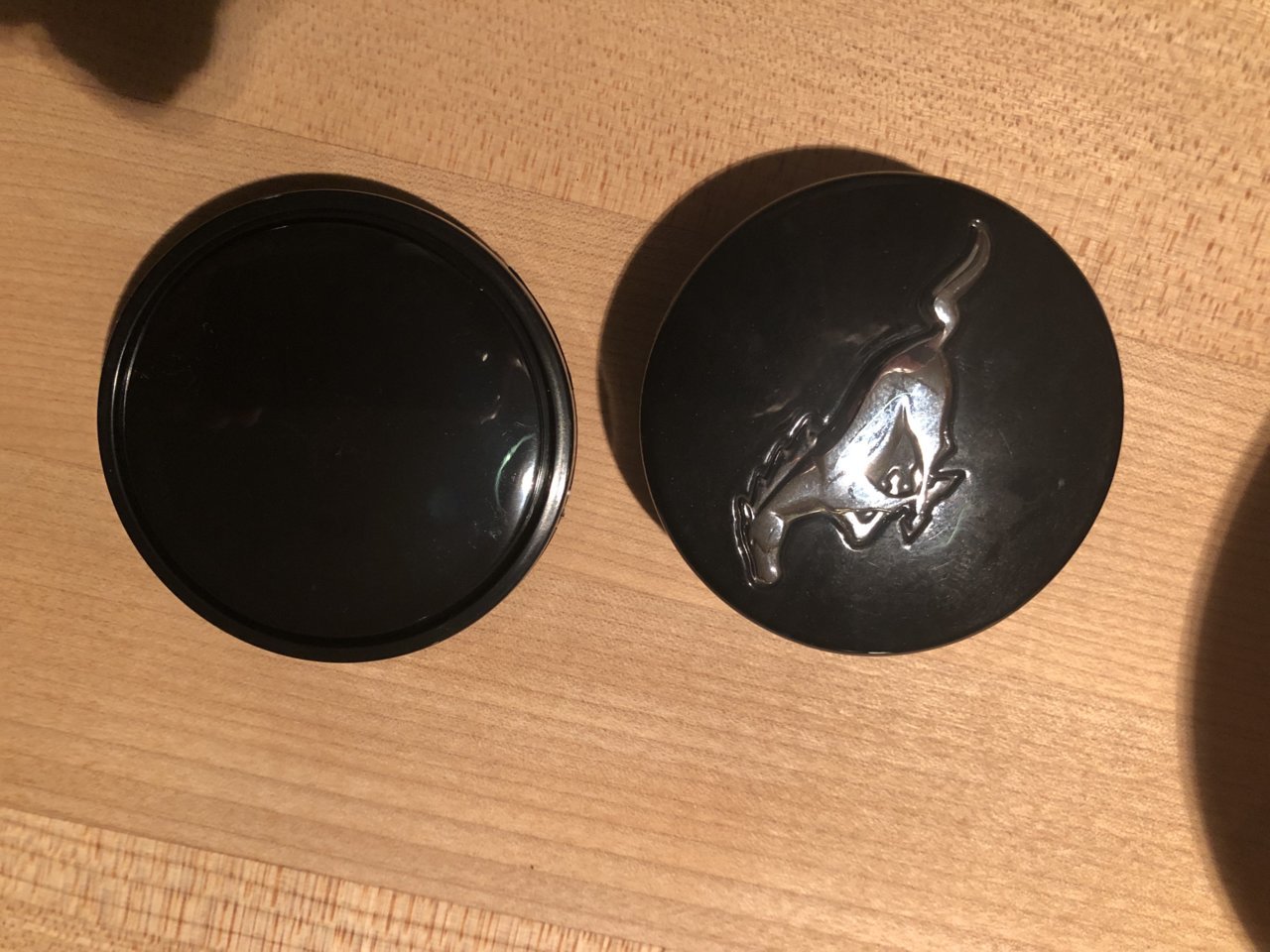

    Bought the set of 17" 2016 Mustang take-off wheels with Hankook Ventus S1 noble2, w 90% tread for $250. Now I need to replace the rim cap and get the correct lugs as suggested by TheBigKahuna (by the way I worked on a film called The Big Kahuna, no relation I'm sure).
    Any chance someone has a link to the proper lugs or suggestions about finding a plain center cap?

    The lug nuts look OK.
    You should also get a set of hub centering spacers.
    The wheels on our Tacomas maintain center on the round center bore of the wheel, not the lug nuts.
    You need a spacer ring to center the Mustang wheels (which have a 70.5mm center bore) on the Tacoma hubs (which are 60.1 mm)
    https://www.ebay.com/itm/Wheel-Hub-...-60-1mm-Aluminium-Alloy-4-rings-/201466003273

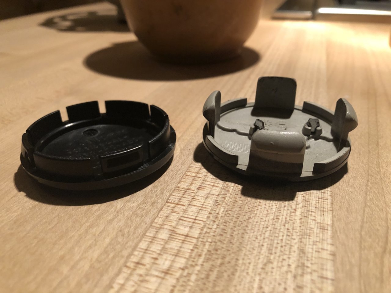

    For the center caps you'll need to pop one off and measure it because there are several sizes listed for 2016 Mustangs. Then search ebay for that size cap. There are literally hundreds listed per size.

    Thanks again for the info. I'm looking into spacers already, but did not have the dimensions. I've found a few options for center caps. Will remove and measure.

    Update: Received the black center caps without logo. These are 56mm Black ABS Car Wheel Center Hub Caps Set of 4 I paid $15 from Amazon. They fit slightly differently then the OEM Form caps but will work just great.

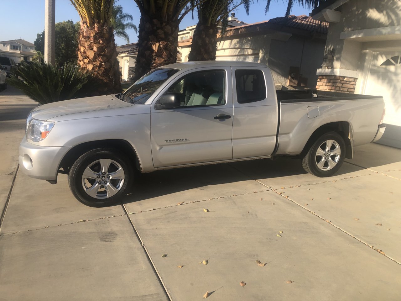

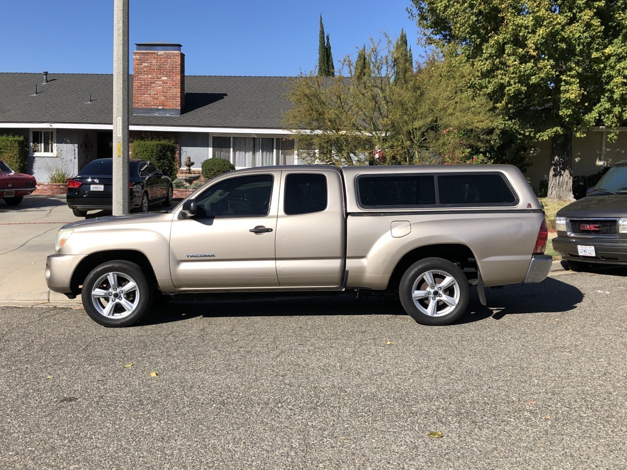

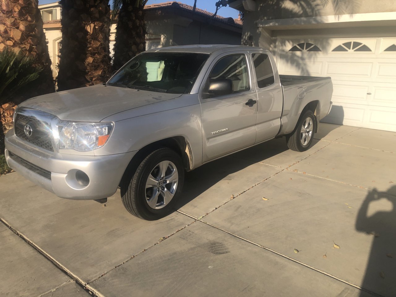

    Update. After receiving the center hub spacers and the plain center caps, I installed the 2016 Mustang V6 Stock wheels. Going from the 15" wheels to these 17", raised the truck about 1 1/2" (1/2" less as the tires are lower profile then the originals). The ride is a little smoother. Hugs the road a little better.
    Here's a before and after...
    Thanks TheBigKahuna for your help along the way!

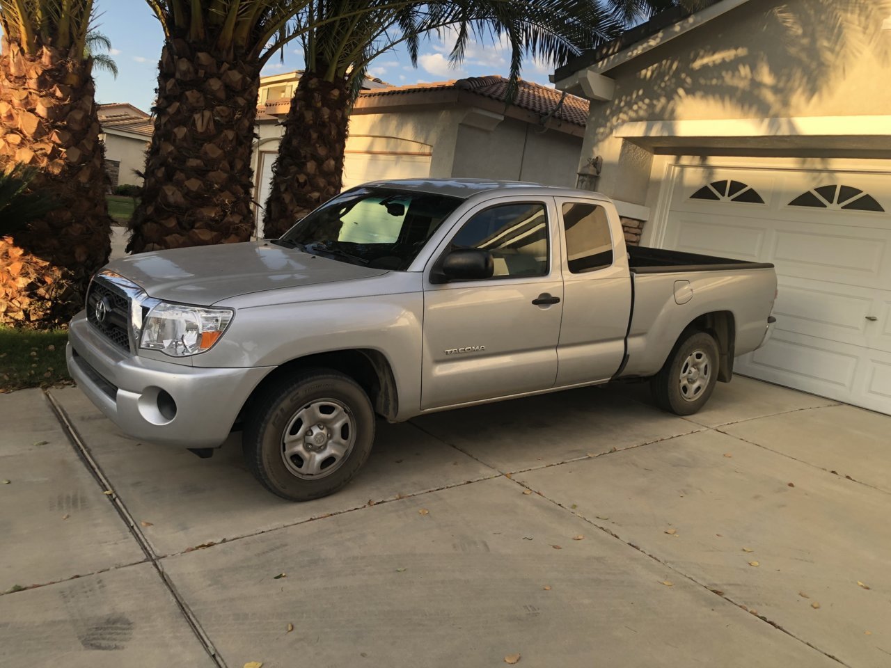

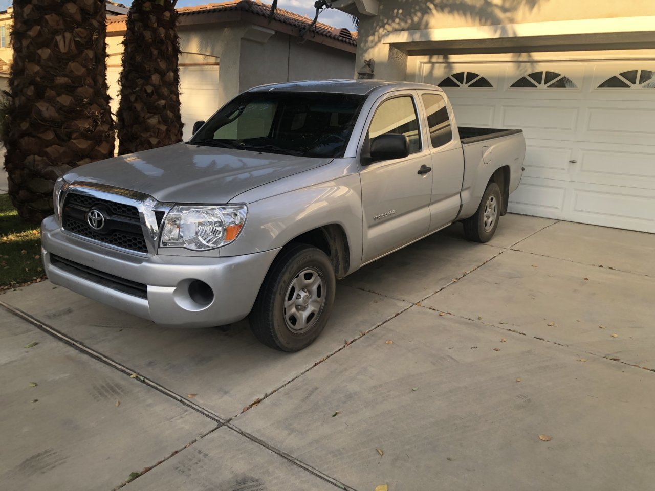

    2011 Toyota Tacoma 2.7L access cab automatic SR5
    17” RAV4 rims

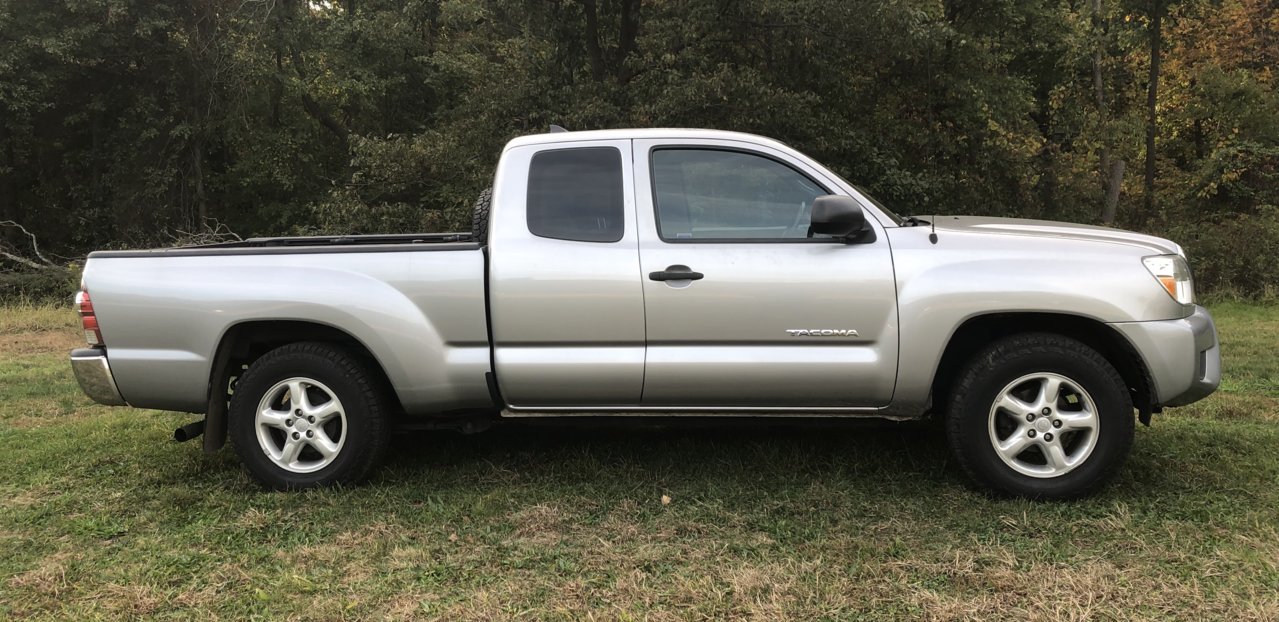

    … i can confirm the 2019+ 17” rav4 rims work on the 2nd gen Tacoma with no rub and no lift…see pics
    Before:
    After:
