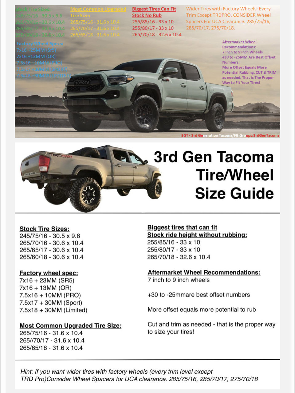

    265/75r16 is the widely accepted max tire size on a stock Tacoma. Just under 32 inch give or take.
