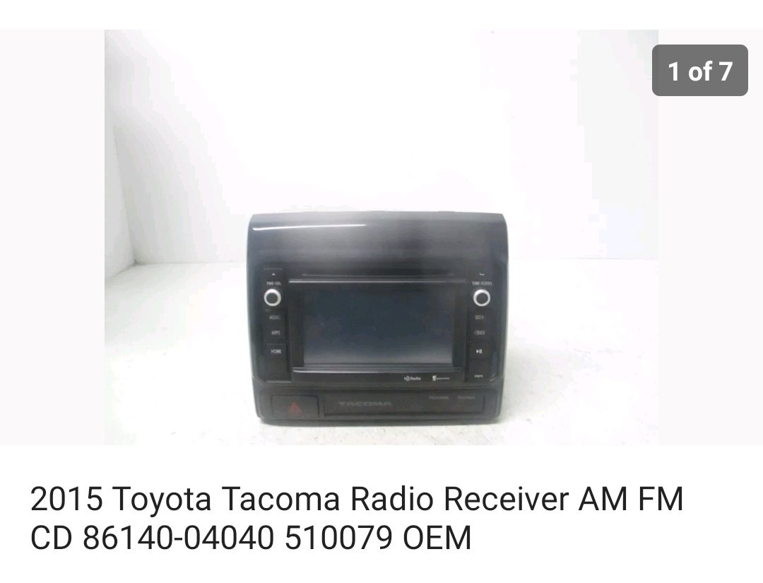

    you can get a newer 2nd gen tacoma surround so you do not have to cut. The one issue you will run into is the wiring. Its different in pre 2012. There are some threads about the conversion. If you go that route I would go with a 2014 or 2015 HU.

    Something like this I can work with as long as I find an adapter for the antenna?
