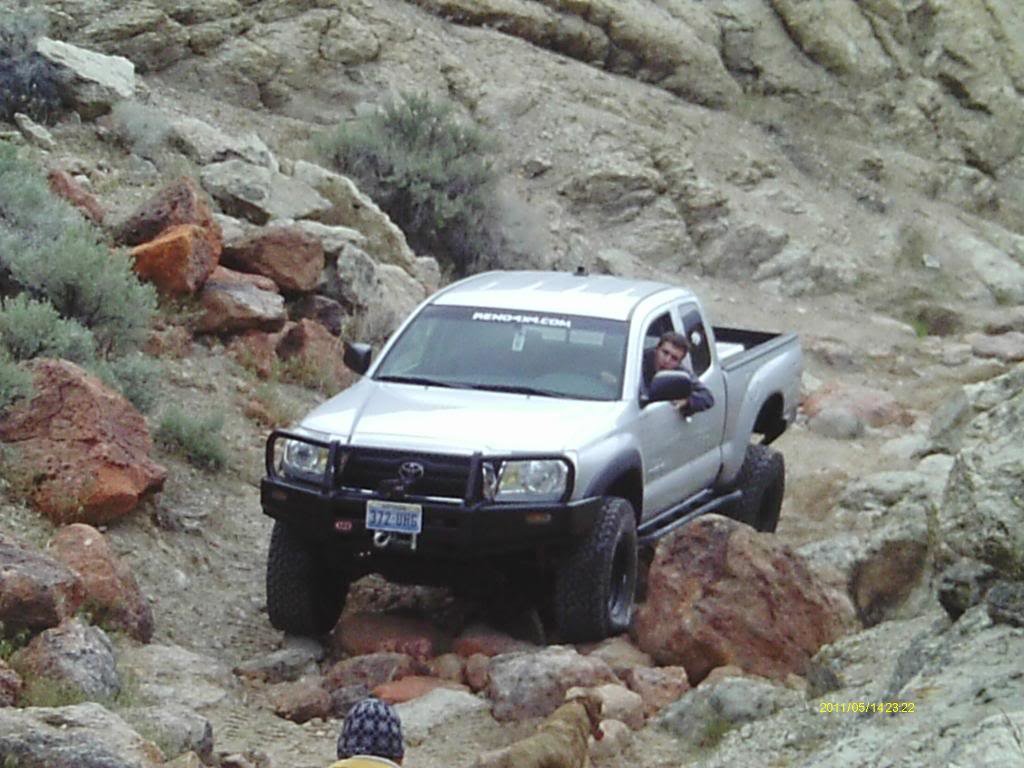

    IMO unless you're really set on it, it's probably not worth the headache.
    By no means for the average TW'er are they easy to fit.
    I had to chop the fuck out of my cab mount, beat the shit out of my pinch weld, and firewall. New wheels with 4.0 BS (4.5 works). Pull the inner fender liners. This opens the intake to debris, cut the intake and pulled it to the firewall, then snorkeled. Cut sheet metal out of my fenders, had the flares narrowed (you can just remove flares, or just cut and rhino line). Cut several inches out of my ARB. Chances are you'll want to re-gear as well.
    It can be done on 3" and isn't that bad really as long as you're not afraid to cut into her. DSC_0180_e10d8968599d7a3695cc8c3d455f0b3acff240be.jpg
