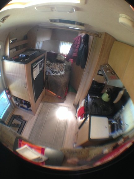

    Haha...Okay, not trying to turn this into a "look at my cool airstream" post but I'll post a couple of interior pics. It's a good little camper and I have been living out of it for almost 5 months. It's getting cold at night here in Wyoming so I'm still learning the ins and outs of living in a camper and not letting stuff freeze.
    The Bambi is a 19 footer. Like I said in my previous posts, towing the camper feels like it's at the limits of what a 1st gen should tow. If it was the smaller, lighter 16 footer Bambi or a fiberglass camper like a Scamp or Casita I think the 1st gen wouldn't feel so stressed out.
