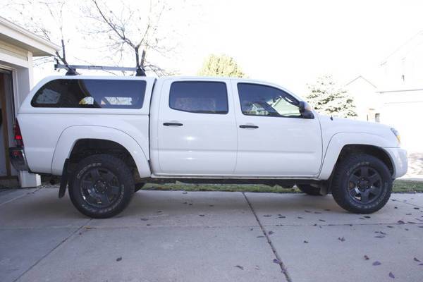

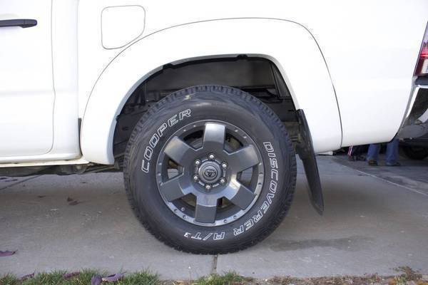

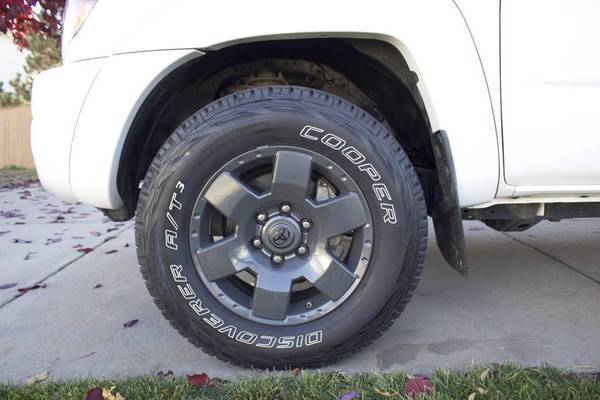

  9. Oct 26, 2013 at 9:21 PM
    #29
    RadoTaco11
    RadoTaco11 New Member
    Jan 2, 2012
    #69830
    Colorado
    11 TRD Off Road
    Thanks for the idea guys. I found some used FJ wheels and had them powdercoated. I really like the fit of the FJ offset. Thanks for the help.
