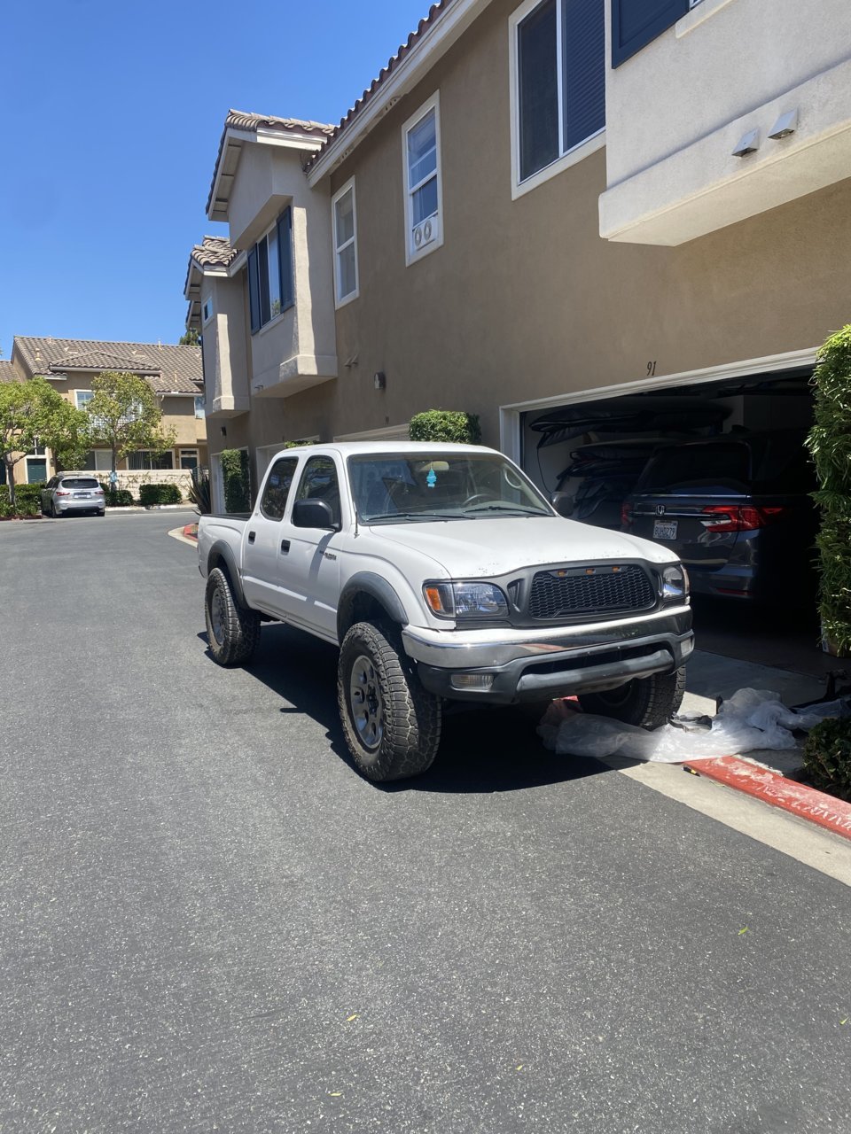

    Also have the revolver wheels with 285/70/17s with 1.25” spacers. Couldn’t be happier :)9D2976D6-D0CB-497C-BBB7-D8FEC0C075CD.jpg
