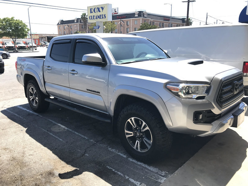

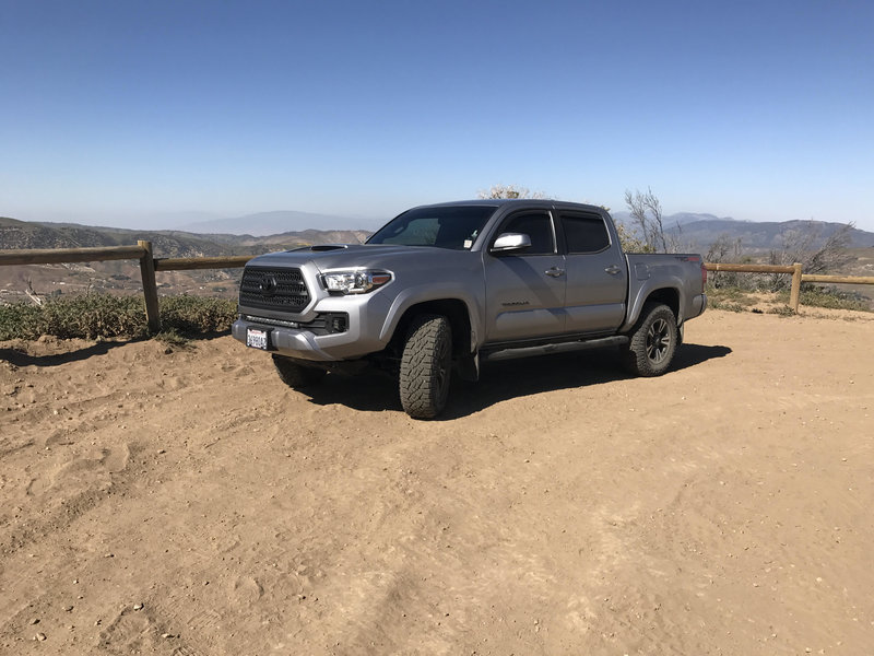

    Hey whats up man I just got these Duratack 265/70R17 i like it alot took to offroading its really good.unnamed (1).jpg unnamed.jpg
