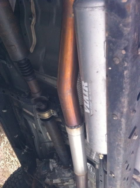

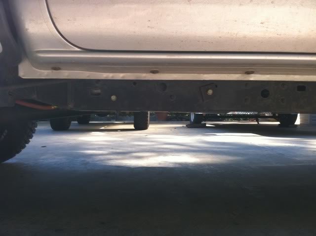

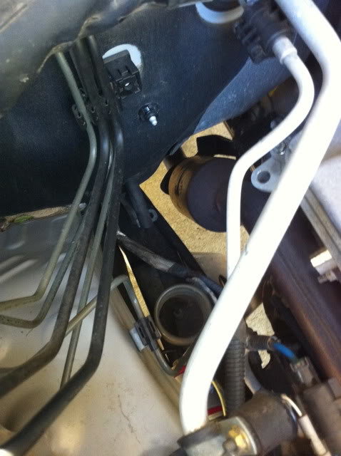

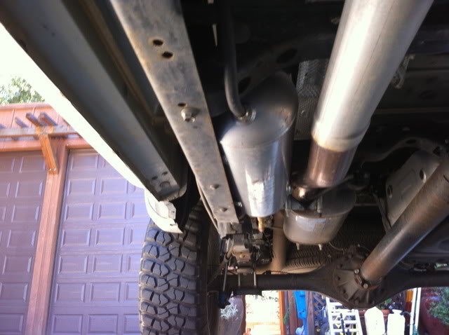

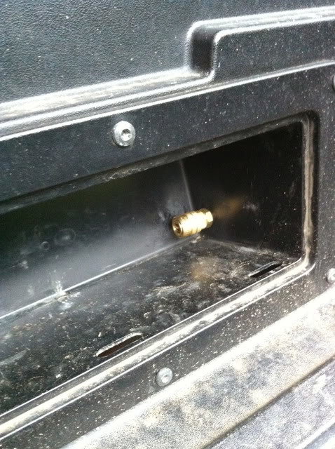

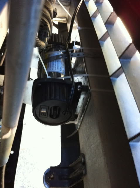

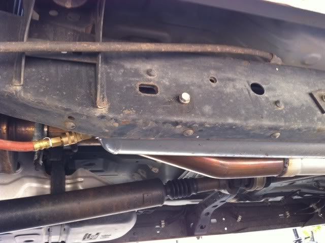

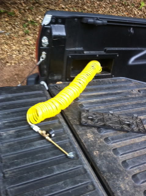

    I was thinking the same as you but I got creative and made a really sleek out of the way OBA.
  19. Mar 27, 2011 at 5:22 PM
    #19
    jackrules
    jackrules [OP] Well-Known Member
    Jun 9, 2010
    #38678
    655
    Jack
    San Diego
    10 PreRunner Double Cab SR5 TRD Sport LB
    how fail proof is your system?
    cuz my brother and my dad aren't very mechanical, and like if their using it I would want it to be so that they couldn't blow up the tank on accident or something if they leave the compressor running....
