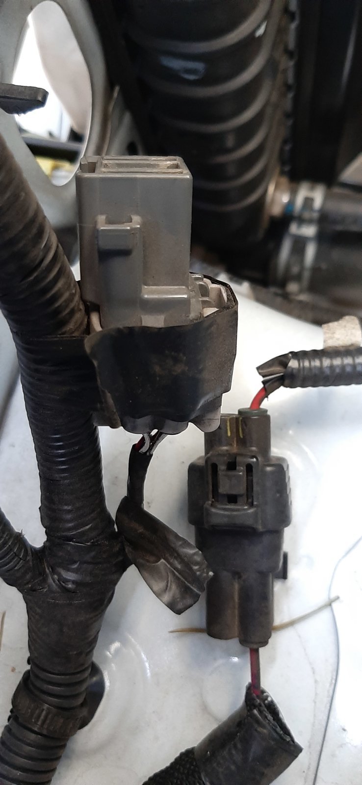

    I just remembered the point of this in the first place. When down several rabbit holes. I have a plug / connector in the engine bay close to the drivers side headlight. It is capped off, and has about 6 wires in the back. Since there was an option for LED light could this be the LED connection? It could not be that easy.

    No, unrelated.
