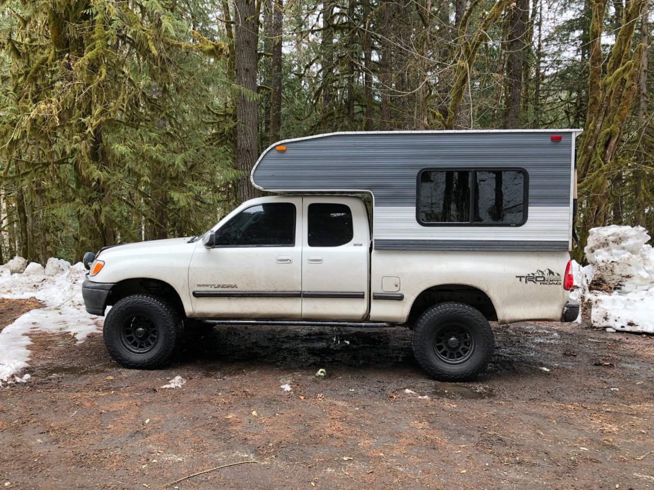

    So to start, I have a first gen tundra not a first gen tacoma.... but you guys should still be able to help me out. So my truck came from the factory with 13WE Calipers, but on my way home yesterday my passenger side caliper decided to lock up. I am gonna take this opportunity to upgrade my brakes to the 13WL calipers from the newer first gen tundras (03+). My wheels are 16x8 4.5 BS with +0 Offset (RRW RR1's if anyone is wondering). I am also running a 1.5 inch wheel spacer to clear my UCA's. Can anyone tell me if my wheels will fit over the rotor and caliper. Many people say that 16's fit fine, but I want to triple check before I spend $300 on the PowerStop brake kit.

    off topic: nice lookin truck!
