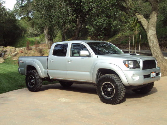

    that translates to a 4.5" backspace

    JUST came back to post that after Googling around haha..
    Would they be fine then?

    I think so.... its perfect on 2nd gens. I know there are guys running less backspace on 1st gens as well though. iirc 4" might be ideal, but 4.5" isnt much difference.

    I'm thinking that reason it doesn't list as fitting toyotas is that they are hubcentric and the hub bore for chevy's it too small to fit toyotas.

    So they won't fit anyway, regardless of backspacing and all?

    Thats kinda what its looking like. You'd have to get the hub size to be certain. Chevy uses a smaller hub, so if those wheels are hub centric for a Chevy, they will not work.

    unless you buy them and route the inside out some..
