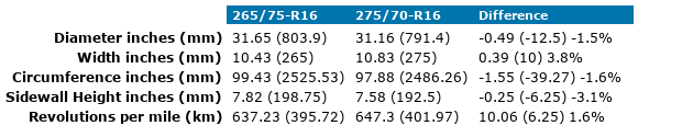

    What about a 275/70/R16 vs. 270/75/R16? Why didn't anyone mention the 275?

    There is no 275/75R16 to my knowledge, at least Tirerack.com does show them as avaiable.
    275/70R16's are slightly shorter than 265/75/R16 and a hair wider. They would look almost identical side by side.
    from the online tire size calculator
