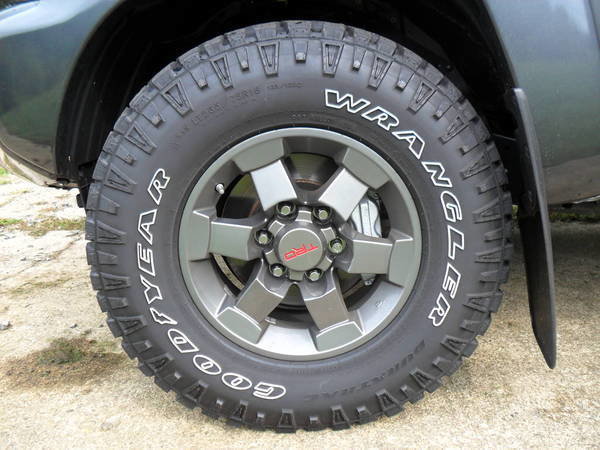

    image.jpgEnded up grabbing a set of the Anthracite TT's from a local dealer. I had the matte blacks one a white 2013. These will go nice on a lunar mist.
