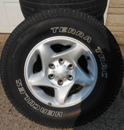

    I ran across a good deal on craigslist and want to know if they will fit on my 07? If so, does anybody have any pics of a second gen with them on it? Thanks a lot guys! :D

    Backspacing is different... IIRC, they tuck in a bit more than stock, but they'll fit.
    Just be aware of possible frame/control arm clearance issues if you're going bigger than 265s.

    I thought they would stick out instead?

    they will work and the best thing is that you can fit 285's on them without spacers :thumbsup:

    So will they stick out further!

    They will stick out 3/4 " further. The backspacing is less than stock.

    Yes 3/4"
    245/75/16 Dungflops on 2nd Gen stock steelies
    255/85/16 BFG KM2s on 1st Gen TRDs
    Any questions?

    Thanks for the awesome response. I like the way they stick out. I bought them this past weekend. So what's the biggest tire I can put on them without worrying about rubbing? Since they will stick out 3/4 more than the stock wheel

    I'm running 33.3" (255/85/16s) The 285/75/16s might be too wide for a 7" wheel. :notsure:
    How much did you pay for them? I got mine for $100.
