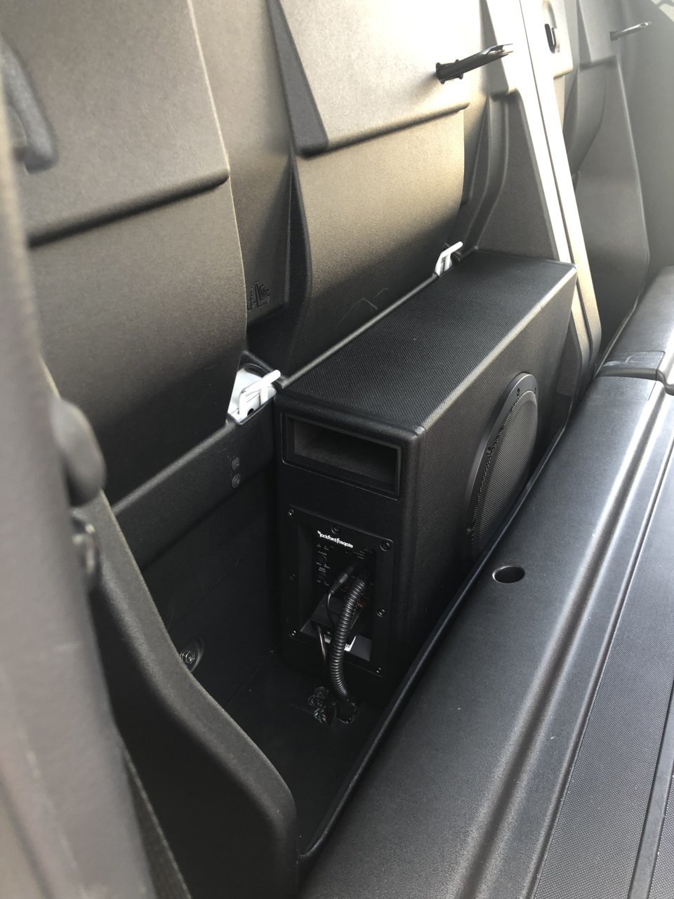

    Just in case anyone in the future wonders about these boxes, I confirmed the first box does NOT fit minus heavy modification. It requires removal of the plastic cubby behind the seat, the plastic panel on the back side of the seat, as well as the plastic piece that runs vertical near the rear seat belt. Also, in order for the seat to latch, you have to put washers or spacers on the latch bar in order for it to make contact with the seat. If the top of the box was angled, it would fit.
    I tried the first box behind the driver's side and the passenger's side and neither side works.

    Seat latches just fine with a nice push

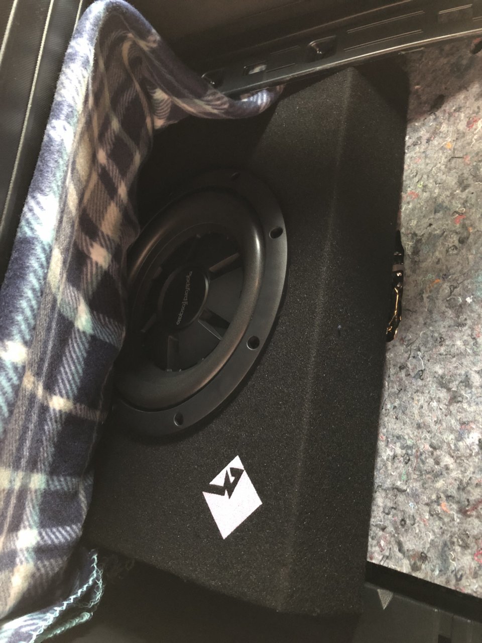

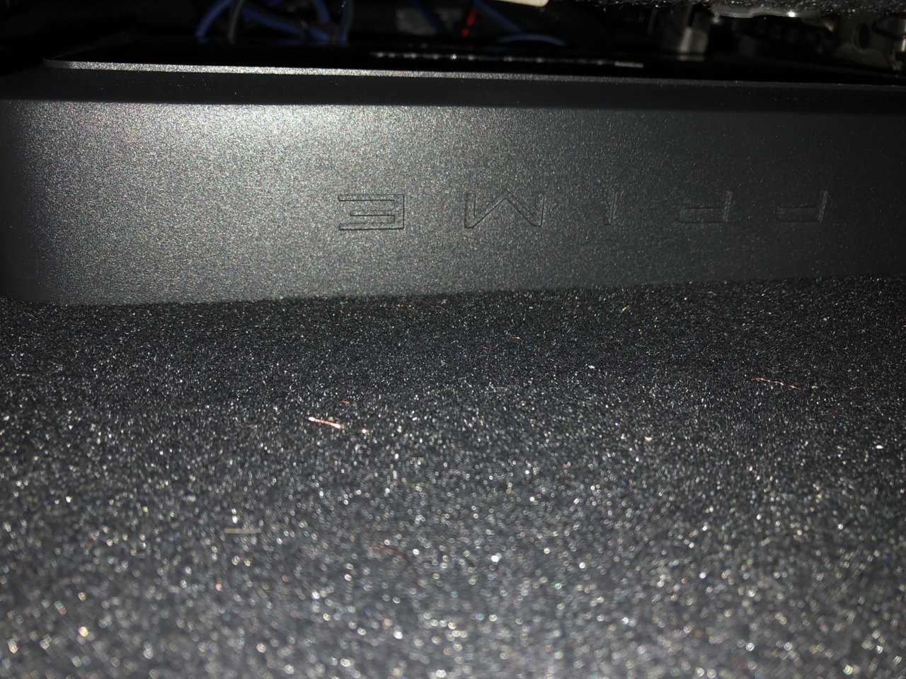

    Here is how my setup turned out:

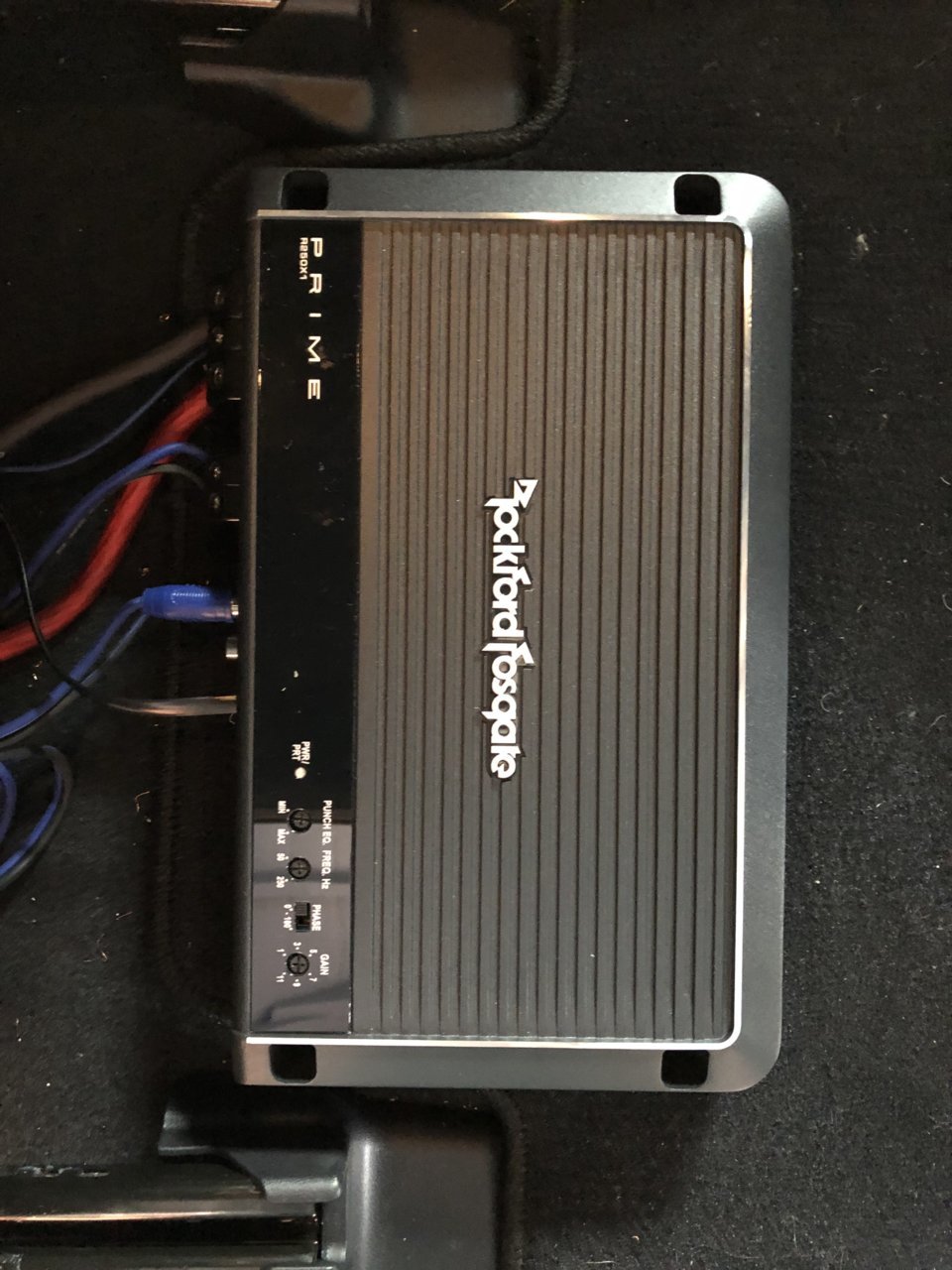

    Amp - Rockford Fosgate R250X1 (https://www.amazon.com/gp/product/B00BF6HX8U/ref=ppx_yo_dt_b_asin_title_o02__o00_s00?ie=UTF8&psc=1)
    Amp Kit - 4 Gauge InstallGear Amp Kit (good budget wiring kit, but the ring terminals sucked) (https://www.amazon.com/gp/product/B01N1SS2ZA/ref=ppx_yo_dt_b_asin_title_o02__o00_s01?ie=UTF8&psc=1)
    Amp Harness - https://www.amazon.com/gp/product/B00CQUL240/ref=ppx_yo_dt_b_asin_title_o01__o00_s00?ie=UTF8&psc=1
    Sub/Box - Rockford R2S-1X10 (https://www.amazon.com/gp/product/B0068XYNH4/ref=ppx_yo_dt_b_asin_title_o02__o00_s02?ie=UTF8&psc=1)

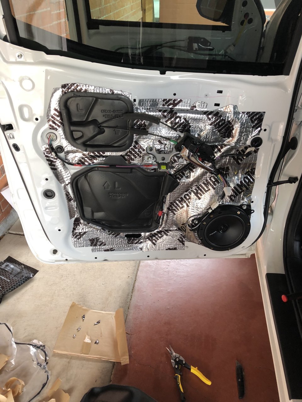

    Front Speakers - Rockford Fosgate 6x9 R169X2 (https://www.crutchfield.com/p_575R169X2/Rockford-Fosgate-R169X2.html)
    Rear Speakers - Rockford Fosgate 6.75" R1675X2 (https://www.crutchfield.com/p_575R1675X2/Rockford-Fosgate-R1675X2.html)
    Tweeters - Kicker Subaru Tweeters (https://www.amazon.com/gp/product/B00PV6F8I2/ref=ppx_yo_dt_b_asin_title_o06__o00_s00?ie=UTF8&psc=1)

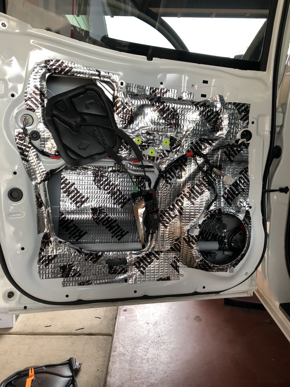

    Sound Deadening - Kilmat 50mil 25 sq ft. This was enough to do all four doors and the entire back panel between the cab and bed (https://www.amazon.com/gp/product/B07CBK48XN/ref=ppx_yo_dt_b_asin_title_o04__o00_s00?ie=UTF8&psc=1)
    The amp fits neatly under the driver's side seat. I will eventually secure the amp with some velcro. The sub/box fits behind the driver's side rear seat with the plastic cubby removed. I covered the box with a blanket so it does not rock back and forth between the rear seat and back wall.
    I spent about $500 doing the entire upgrade. The amp was an open box Amazon special. The longest part of the install was the sound deadening which took an entire Saturday afternoon. All in all, the install was pretty easy.

    Where did you run ground too? Does the plastic rattle or since it's a pretty snug fit do you just feel the bass thud?

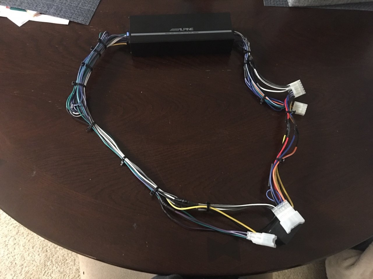

    ^^ Exactly.. this is an Alpine Power Pack that is bypassed in between stock HU and stock speaker wiring. Door speakers and tweeters were replaced with Kickers all around. Power pack sits nicely behind/under stock HU. Completely plug and play setup no need to splice a single stock wire.
